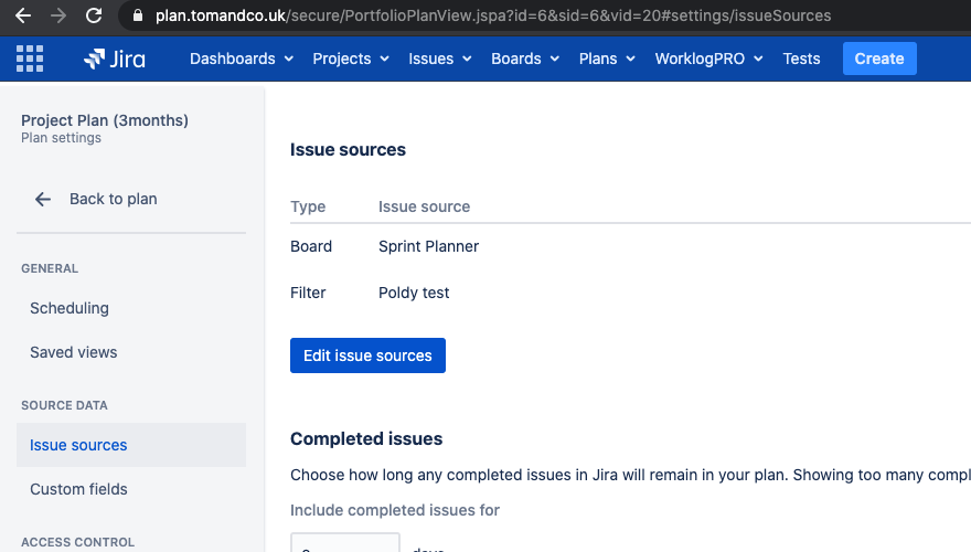

I pretty much have Advanced Roadmaps doing everything I want except filtering out certain projects from the board that I need to draw from. We have a company sprint planner board which includes two types of projects, 1) Projects, 2) Retainers. These are differentiated by "Project Category" in JIRA. When I choose the relevant board in the initial config, I would like to filter so that it only pulls in "Project Category = projects". I can manually remove the projects but after syncing with JIRA they start to reappear.
In the initial config there are four or five steps where I would have thought this was possible but it doesn't seem to work:
1. Issue sources
If I choose the board AND a filter that only pulls this project category it makes no difference - all pull through. I assume that's because the "filter" doesn't filter the sprint planner or something?
2. Releases
I choose the relevant releases for only the projects I want, doesn't filter them out when complete
3. Issues
You get an option to choose which issues you want to pull through. I de-select all, then one by one choose the projects I want, and click Select all for those - it still pulls through other projects that I don't want.
What am I doing wrong here? Seems basic and apologies if it is! Thanks for any help in advance.

Leopold van Lynden
November 20, 2020
Just to follow on to the question here, if I have a board with 40-odd projects, but only want to pull in the "Website Build" ones (differentiated from "Retainer" via Project Category in JIRA, shouldn't that work with a filter from Issue Sources?
I find that even though I have the additional Filter (which essentially allows only "Project Category = Website Build" it doesn't do anything, and eventually through syncing, the retainer projects will just start pulling in. Any ideas? Thank you in advance!
