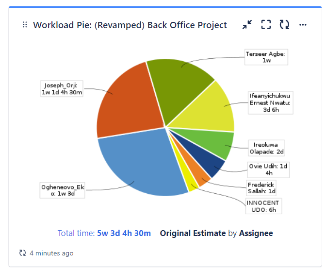

PADMA KOTHAKOTA
November 14, 2018
Hi @Naama Betzalel,
I think you can use any of the below methods
Method1:
Create a JQL filter like assignee= xyz and sprint = abcsprint
Add "Workload Pie Chart" Gadget to the Dashboard
Set the "Time filed report on" as Original Estimate
Method2:

Boluwatife Adewole
August 21, 2024
Method 1 worked perfectly.
