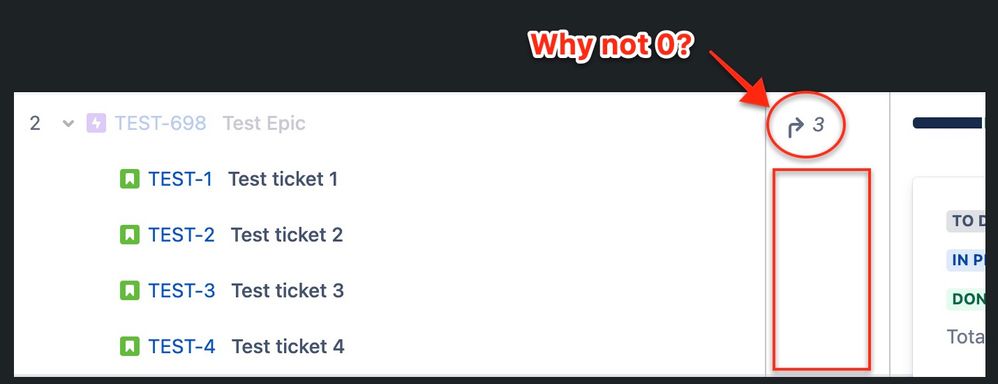

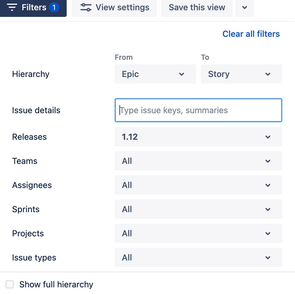

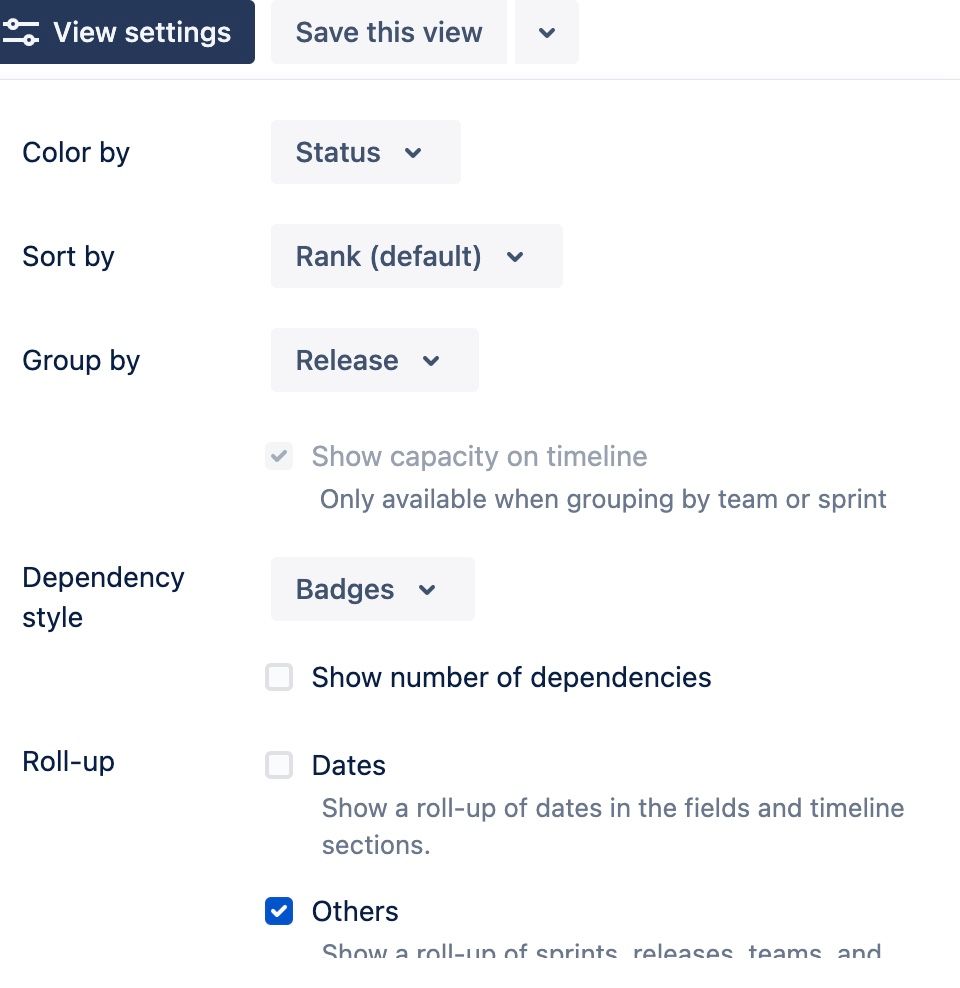

I have an Epic which spans a few fixVersions. In my plan/scenario I am filtering on a single release, 1.12. The issues in the listing have no story points, but the Epic is still showing 3 rolled up points (the 3 points are from v1.11). I have tried grouping by everything, nothing changes it.
Ideally I would see "0" so that I can know exactly how many points total are committed in this version 1.11.

Epic TEST-698
v1.11
TEST-0 (3 points, "done")
v1.12
TEST-1 (0 points)
TEST-2 (0 points)
TEST-3 (0 points)
TEST-4 (0 points)

The epic is still showing those issues because they're still part of your plan. The filter just removes them from showing on your timeline, but they're still part of your plan and thus your calculations.
In order to have the calculation do what you're asking, you'll need to remove it from your plan using an exclusion rule. This allows you to remove issues based on their status, among other things. The full documentation page can be found here. The downside is that this will make your plan very forward-focused (for good or bad)
Another way to view this information you're seeking might be to enable the Progress column on your plan. Full documentation on the feature here. This shows you the breakdown of work done versus work completed. Now, it wouldn't exactly be compared against your release/fix version, but it would show the breakdown of the epic.
