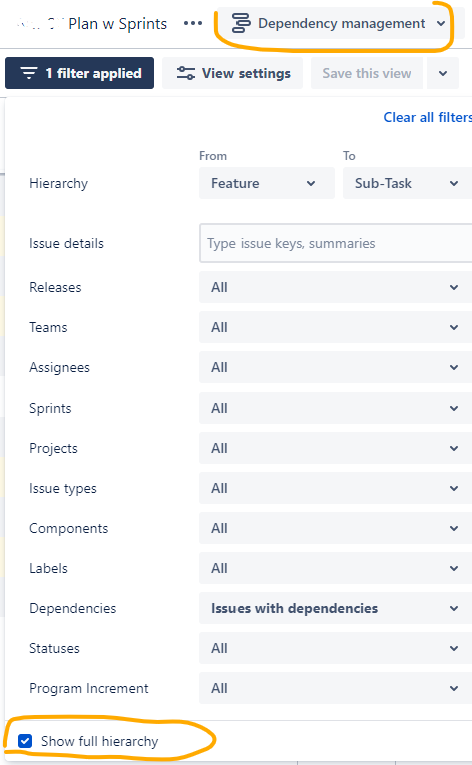

I'm not entirely sure I know which view you are asking about. Do you mean the pre-set "Dependency Management" view? or the "Dependencies Report"??
If the former, unticking "Show full hierarachy" should tidy up that view.ar1.png
For stories not linked to an Epic, it is true....they logically have nowhere to roll-up to. So yes, to roll them up they would need to be linked to an Epic.

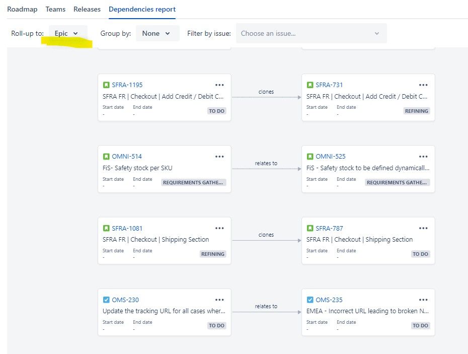

In this smapshot, I checked and the OMNI-514 and OMNI-525 actually belong to an Epic, yet, they are still not rolled up to it.
Is it possible to somehow choose which dependencies/links I would like to see - for example, Cloned tickets are not relevant for this view, and there are a lot of those which is just cluttering the view.

Are the Epics visible in the Plan? as that doesn't appear to be rolling up at all.
How different is the view when not "rolled-up"?
Regarding which dependencies you can view. That is set globally in the Advanced roadmap settings and cannot be further filtered in the Plans/Dependency report. I like the idea though, you should give that feedback to Atlassian via the "Give feedback" button

Yes, in the plan, I have Stories , Epics and Epics linked to Initiatives by Parent link. And it seams that the view stays the same if I roll up or not. Could this be a bug and maybe I should reach out to Atlassian?

I am facing the exact same issues. With some experimenting based on what configuration options there are for plans, I found out that the roll-up was working for a plan that was based on a project as an issues source, and didn't work fpr a plan based on a filter. When I switched the source of the filter-based plan to a project instead, the roll-up worked.
Might there be limitations when dealing with filter-based plans?
