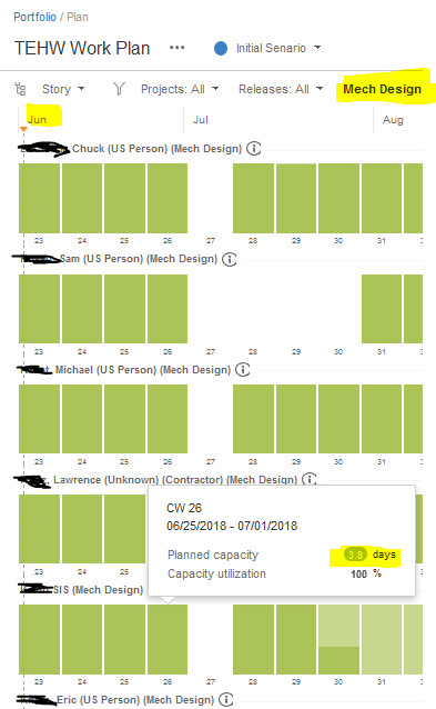

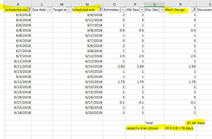

When I export the scope report out of Portfolio and look at the estimated hours for a particular team over a period of time (say June). I would expect that it would match what the capacity chart in portfolio reports, but it's way off.
As you can see from the attached images, the capacity report shows my 5 mechanical designers at full capacity for 4 weeks (30 hrs/week ~ 3.8 days). That should be about 600 hours.
However, when I break down the estimates in the exported report for scheduled stories  in June, it's only showing 300 hours of work. It makes it look like I only need 1/2 my guys.

Some other info, the plan is set to one person per story (which is accurate to reality), each person is available for 30 hours per week, portfolio picks the team member based on where we estimate the hours (if we put 2 days in the mechanical design skill, it picks the right team).
