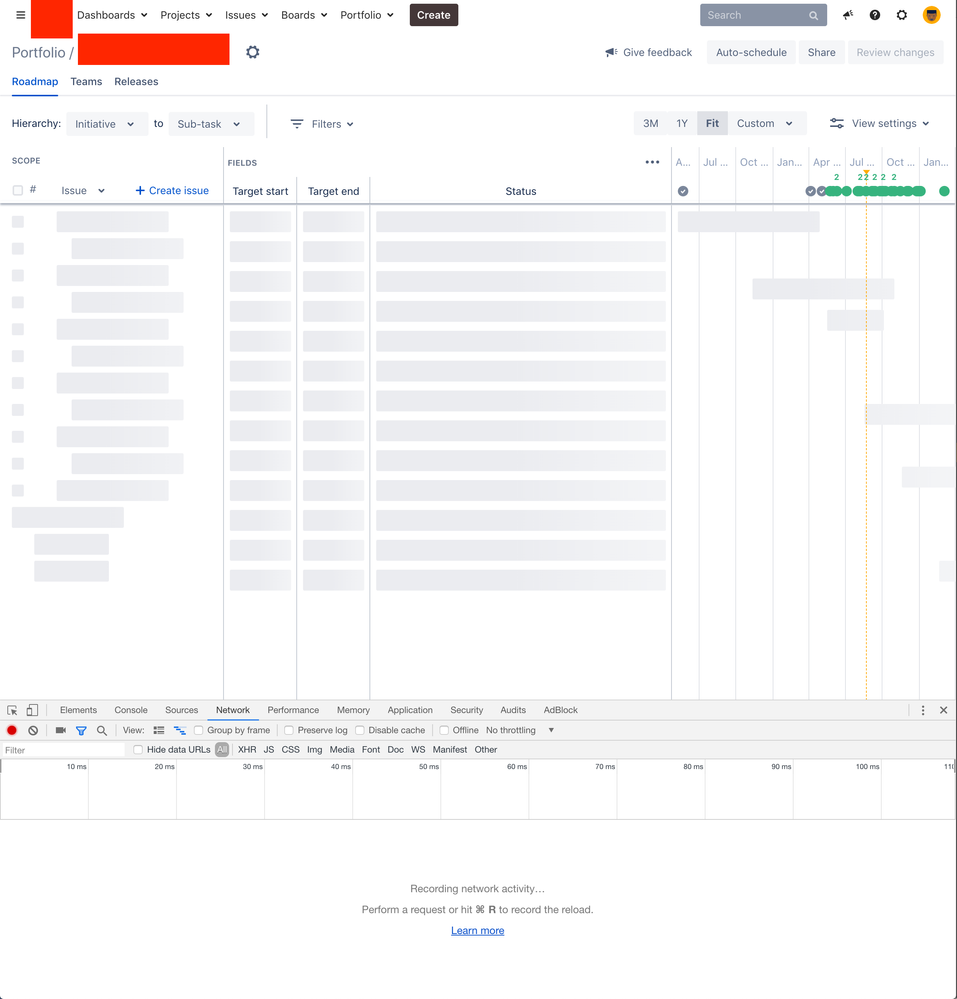

When attempting to view a Jira Portfolio Plan it refuses to load. I've had this complain from multiple users and have even received an error. Is anyone able to advise?
Screen Shot 2019-08-20 at 4.15.56 PM.pngScreen Shot 2019-08-20 at 4.42.10 PM.png

No, the reason I have the tabs open in the screenshot is to show how they never load any data. Though the UI makes it seem as though Jira Portfolio is "Starting Up"

From the screenshot I can see that the page scripts have loaded, as the loading indicators are displaying. These continue to display while the scripts attempt to retrieve the backlog data for the plan, so there's either going to be an error retrieving the backlog, or an error processing the data that's returned.
