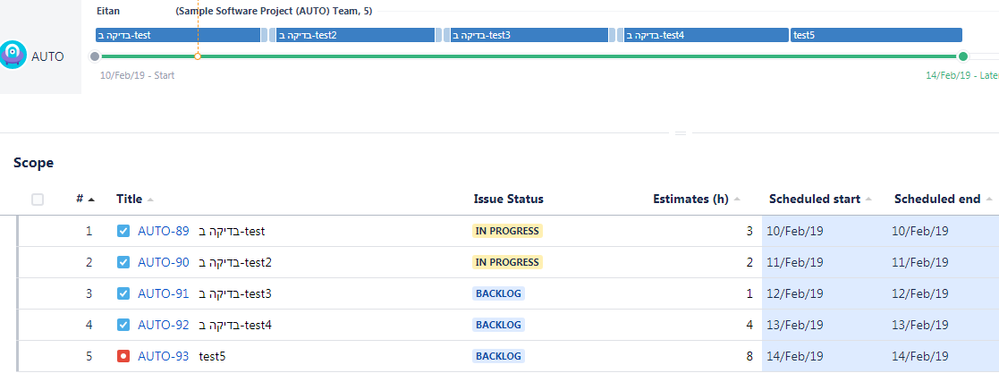

I installed the Portfolio for Jira plugin and have a few questions:
1. Is there an option to automatically adjust tasks based on the level of prioritization and creation date?
2. Can I add a "priority" column to the scope table?
3. I have defined a working day as 8 hours, but when there are several short tasks (with less than 8 hours of work) are shown in the scope they currently work.
Attached is an illustration:
{In the attached picture, I have made the task conditional manually}.
I would appreciate your reference,
Eitan.

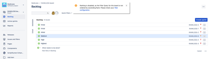

For point 1, Portfolio uses the Agile Ranking functionality in the schedule layout for the defined order. The board must be ordered by Rank in order to use the drag and drop functionality and ranking is a big part of the scheduling algorithm. You can Disable Ranking by changing the Board filter "order by" values for a custom level based on prioritization and creation date but in doing this you loose the benefits of agile ranking and all items would need staticky assigned variables rather than dynamic prioritization defeating the intended purpose of the plans design. Basically the plan would not plan for you and you would need do everything manually, So I would recommend against doing this.

For Point 3, the Lighter Blue highlight end caps on the schedule indicate dependencies on the issues that prevent one from starting before the next can start. Additionally make sure you have Team Members with available Capacity.

Hi Earl,
Thanks for the answers.
For your first answer -
Do you mean that you can only arrange them automatically using a filter, but the logical stipulations between tasks need to be done manually?
For your second answer -
Do you know when they will implement that issue that been opened?
For your third answer -
I don't understand how it connected to the fact that task with Original Estimate of 3h is like a task of Working day (8 hours).
How do I solve this problem?
Best Regards,
Eitan.

For an example on the ranking conflict that can occur, if you order say by Priority "project = RANKLESS ORDER BY priority ASC" in effect disabling the Rank, on the board the order is now defined by the Priority, and also Alphabetically. They are grouped together but you can no longer drag and drop to rearrange or you get this popup error (the data ordering is Static based on priority):
