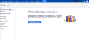

Hi Brendan,
When looking at the plan configurations page for a Live Plan you should see the option to enable the new planning experience under the op configuration option like the following screenshot:
What is this screen looking like for you?
Regardless, the option should be there but would be greyed out if your Portfolio global permission settings were set to Viewer as covered here, and you would need Portfolio Restricted User or higher to enable the new experience.
However if it's not the global permission, I would expect something failed during the upgrade to 3.9, check the logging to see if there are any explicit errors during the upgrade window for portfolio, and I can take a closer look.

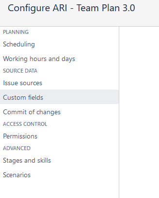

Brendan Byers
September 4, 2019
Hi Earl,
The option wasn't appearing at all:
However support was able to direct me to this KB article when trying to address a separate issue:
https://confluence.atlassian.com/jirakb/portfolio-fails-to-save-auto-schedule-changes-972333167.html
Following the steps suggested there, appears to have resolved the issue.
