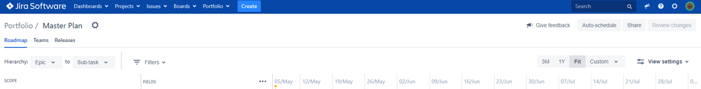

Hello all,
I'm really new to Jira so sorry if my question sounds a little bit dumb.
I checked the doc for the Capacity view for Portfolio 3.0 but I'm not able to find the "Capacity view" button anywhere.
https://confluence.atlassian.com/jiraportfolioserver/using-the-capacity-view-826889108.html
I don't even find the button "Calculate".
So my guess is that I have to "create" something and it will enable the button somewhere.
(Like for example with the app Capacity Tracker - You have to create a sprint in order to enable the button "Capacity Tracker" in the left menu. This might have been obvious for you, but took me a few minutes to figure out actually)
I have portfolio 3.0 installed on Jira software 8.1
Let me know if some information is missing.
Thanks
Iswaren
Iswaren Mardenalom
May 7, 2019
Hello,
It seems that I've found my issue.
It's the redesigned interface option. (Enable improved interface)
@[deleted] You might have to update your KB :)

After reading all of these documents, I still can't see the capacity on 3.0.  I can turn it on in view settings but I can't see the sprints in the roadmap view.  Can you help?
Thomas
June 12, 2019
Hi @Jamie_Demboski
I'd suggest checking that the Jira Board that contains the sprints you are looking for is part of the Plan issue Sources.
Using Projects or JQL Filters will not bring sprints information.
Let me know how that works out!
