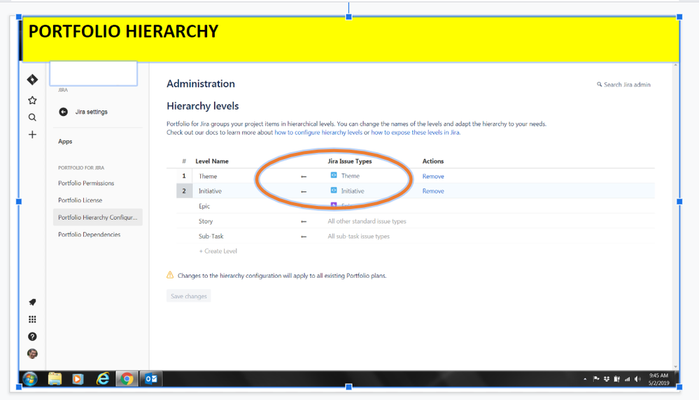

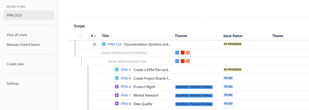

I have been looking specifically for the screen on which I get to indicate that the Initiative that I already defined (see picture) as an Issue Type in both Jira and Portfolio is a Parent Link . No one has shown me where that is or how to get to it.

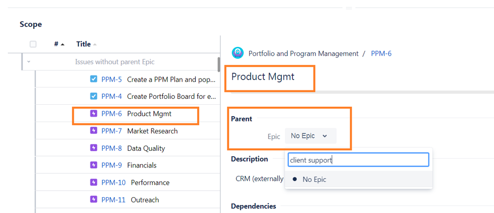

On my own, I discovered that when I am in Portfolio live plan, I currently see no individual Epic-type issues listed at the Issues without parent Initiative level (see picture) but I must drill down further to the Issues without parent epic level. No issues without parent initiative.png
But if I then select an Epic I currently get a screen that asks me to identify another Epic (!!) in the Parent Link field -- obviously neither rational nor desirable. I don't know why my screen does not show me an opportunity to indicate an Initiative as the parent. (See picture). Note that the details screen does NOT say "Parent Initiative"...The screen makes me think that for this "Parent" linking function, in my current setup, the Portfolio does not know how to find the Initiatives that I defined both as an Issue Type in Jira and as a Portfolio hierarchy level (already "mapped", yes? See picture). My project in this portfolio is a New Gen project not a Kanban or Scrum project.

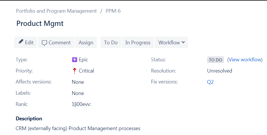

When I view PPM-6 it currently displays with an Epic icon (which is what I expected and always thought I created from the beginning..)

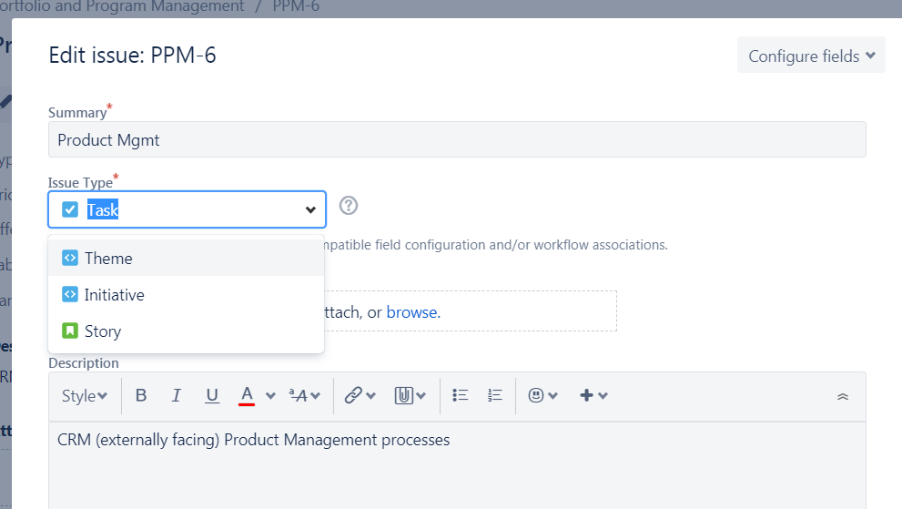

When I EDIT PPM-6, the edit screen (below) shows me issue types NOT including EPIC, which I could select and Save but I don't want any of the displayed choices and also I don't know if this screen is trying to tell me that the issue type is actually NOT currently an epic... Anyway I made no selection here and instead cancelled, which again gave me the view screen showing PPM-6 with an Epic icon.

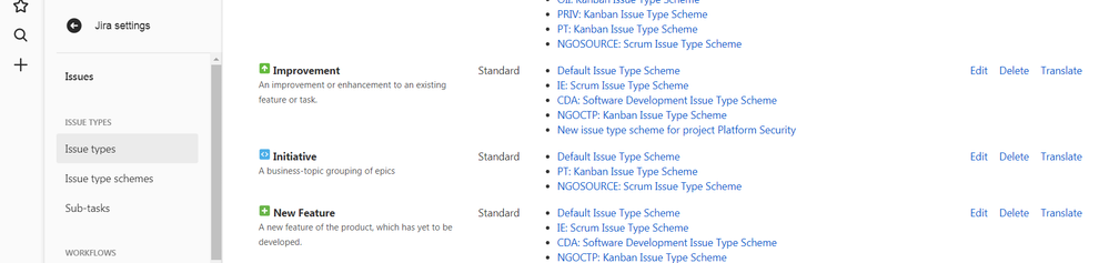

To check the Issue Type Configuration  I went to the screen that allows me to edit the configuration. When I went there the Initiative type was listed but "greyed". I edited the type by supplying and saving a description for it. Since the associated screen types shown already included "Default Issue Type Scheme..." I am unclear on whether I still need to name a different screen than the screens I've already been looking at for a couple of weeks displaying issues I defined as Initiatives.
On that same screen (Jira settings >> Issues >> Issue types) I also verified that the Epic issue type is only visible one time and not being duplicated., while also associated with the "Default Issue Type Scheme".

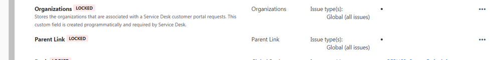

So, with the above, I hope you can push a little deeper into why so far I  don't have a screen that lets me set an Initiative issue type as a Parent link. The other piece of info I can give you is that currently when I look up Custom Fields the Parent Link field shows as Locked. (In the picture here I  masked/hid the current screens in use since this forum is public...)
