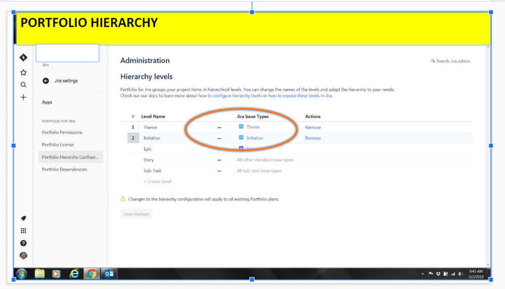

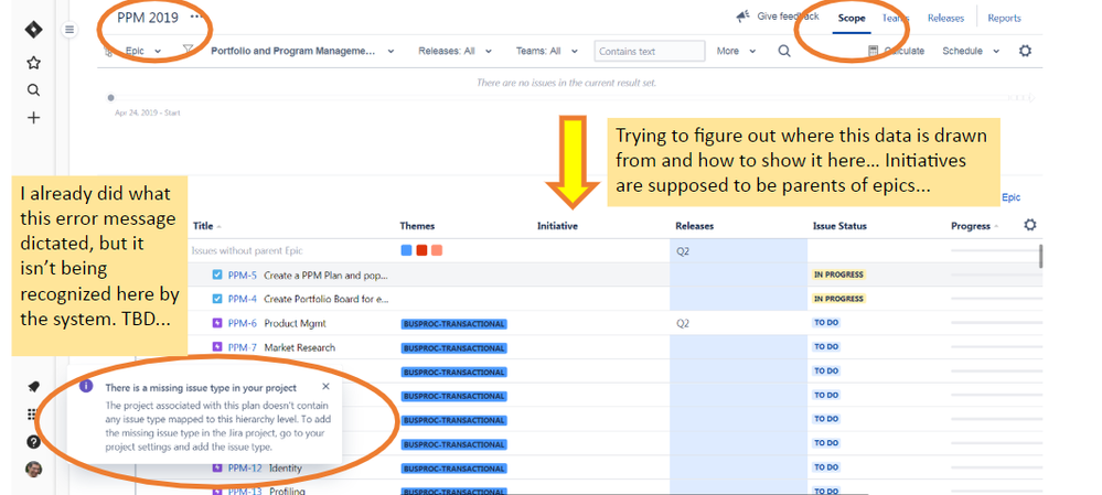

Hi. I had already configured the hierarchy levels including creating and naming Themes and Initiatives.
I had already also created (entered) Issues that I categorized as Initiatives as well as others categorized as epics etc.
I have not seen an indication in the user interface that said I was incorrectly defining or describing these items.
However I get an error message that does not correspond with the actions that I have already taken. See the two pics attached here.initiatives missing in Portfolio view.pngportfolio hierarchy config.png

The hierarchy looks good to me.
The Initiative column in your screenshot displays linked parent initiatives of the Epics shown.
  • To link an Initiative to a specific epic, you use the Parent Link field (put it on an Epic screen, and populate it with one of the Initiatives you've created). Parent Link is the field that drives all of the connections above an Epic (you parent link an Epic to an initiative, and you parent link an initiative to a theme).
To view all Initiatives in the plan, change the hierarchy level here in the top left to Initiative, rather than Epic.
Are there any projects other than PPM being pulled into the plan? You could be seeing that error if *any* of the projects sourced are missing any of the issue types in their issue types schemes (Initiative, Theme, Epic).

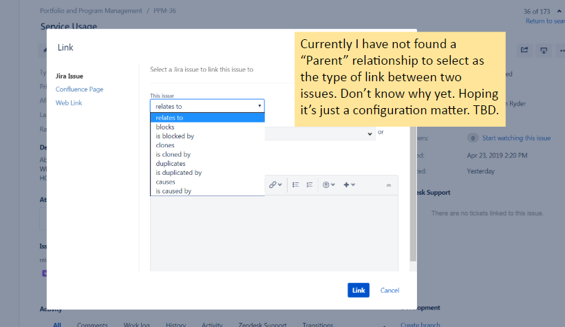

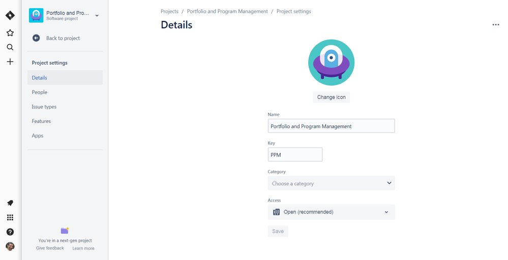

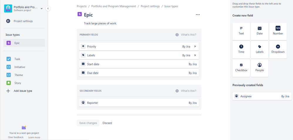

Attached pictures here: I know it is not at the location where I can select the behavior of a link between issues.
And I know it is not, for example, on the screen configurator for an Epic issue type.
Can you give me the step by step path to the screen where I can see and apply a Parent Link to an Issue type of Epic? My starting point is the Projects/Portfolio and Program Management/Project settings screen Available behaviors of linked issues.pngEpic Issue Type configuration screen.pngProjects Settings screen.png

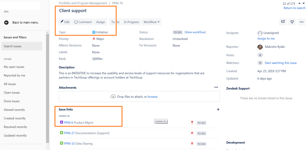

An additional note for clarification:
I already have (as seen here) an Initiative explicitly related to an Epic.
But if I go to this same Epic in the Portfolio Scope screen and open it, Scope says that there is no parent.
If I then search for a parent (also as seen here), I only have the option of searching for other Epics -- which of course does not make sense.
Initiative with a Related Epic Issue Link.pngSearch for Parent of an Epic.png
