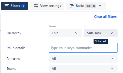

I was having the same issue, but mine was filter related Screenshot 2023-01-30 133543.png

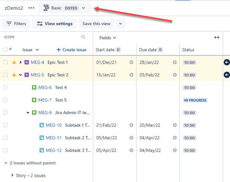

Just found something interesting that the subtasks seem to show up only if one is viewing the "Basic View".
I would recommend you to reach out to Atlassian support for additional assistance.  Please post back their response to your ask.

@Joseph Chung Yin - The view i have been accessing the plan is the Basic View. But the difference in my case is that the subtasks are created directly under the initiative Issue type as compared to your case of having the subtasks created under the Story Issue Type.

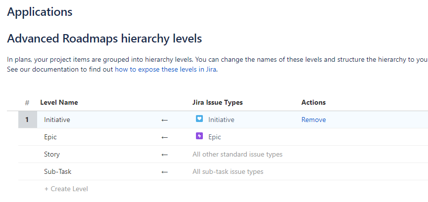

Here is another observation with Advanced Roadmap for Jira regarding to Initiative issue type.  You should confirm it with Atlassian Support team to see if my observation is correct.
Observation -
Initiative is a parent of Epic issue type and it allows you to create subtask under it in the UI.  However, the AR for Jira Issue Hierarchy configuration doesn't support subtask roll-up directly against the Initiative.  Therefore, the plan will not display subtasks associated with the Initiative issue.  Another question to you is that why you want to create subtask against Initiative issue type?  Again, Epic issues roll up to Initiative issues, thus the usage of subtasks seem to be incorrect.
NOTE - If you are using Jira Server/Data Center env, the subtasks associated to an Initiative shows up properly but not in the Cloud env.  Don't know if there is a bug within the Cloud env or it is by design.
Hope this further assist your question.  As mentioned above, please confirm with Atlassian Support and post their replies to share with us in the community.
