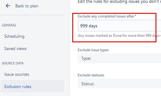

Not sure I follow your question...  You're filtering to only see active or future sprints, but also expecting to see older sprints??  Seems like there is a conflict in your filter and expectations :)
That said, if you're looking to see PAST issues, make sure your history exclusion days setting isn't too small for what you're trying to capture.  This is located on the configuration settings under the Exclusion Rules.  Picture attached:

Ah, yes, I misunderstood, apologies.  I think it probably depends on the specific JQL driving your filter.  I have been successful using the Filter input source, but it is obviously  highly dependent on your source JQL filter.  When you run your filter from the advanced Issue Search do your results contain the issues that aren't showing up on your plan?
Note:  The Release/FixVersion field is also key to ensuring your issues are being displayed.  This caused me much frustration at first, so it may be something to look into.
