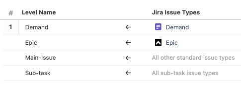

We are using on our DC Instance Advanced Roadmaps and the Hierarchy defined by me is not visible.
2. I added it as the top level in the hierarchy setup
3. I have 3 EPICs which I linked to a Demand and they are visible on the Demand as children
4.But for some reason the hierarchy is not visible in Roadmaps

Kruno
April 21, 2022
Here the Screenshots as I wasn't allowed to add them with the initial post.

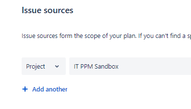

@Andie Duframe
1. If you click on the three dots by the plan in the upper left hand corner...
2. You should see a popup menu - click Configure.
3. On the next page, you should see "Issues Sources" down the left-hand side of the screen:
4. Then look in the middle of the screen and you should see a list of Issue Sources. It could be Project, Board, or even Filter....
So - this is the screen shot @Joseph Chung Yin was looking for.....what does yours look like?

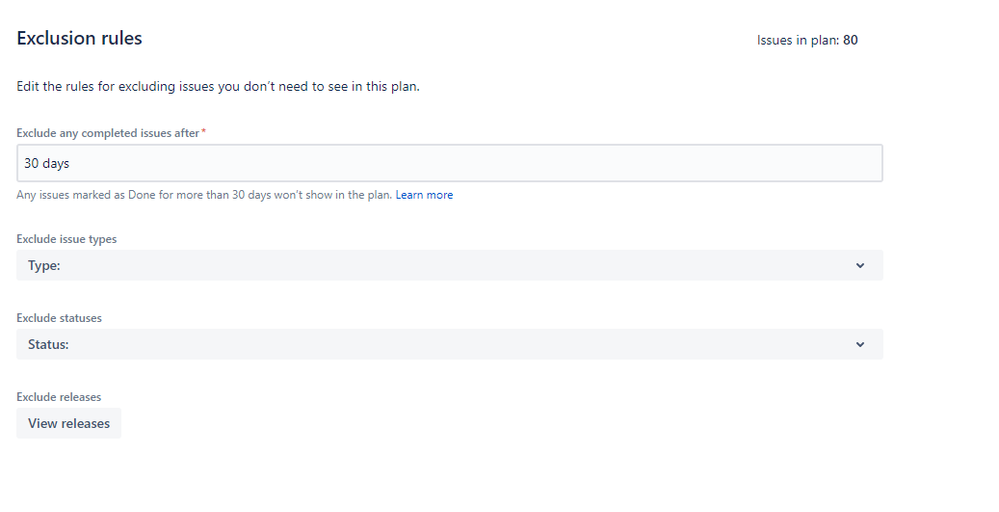

2) Can you check what you have in the Exclusion Rule setup to ensure that your issues are not be excluded from the plan.  Example -
