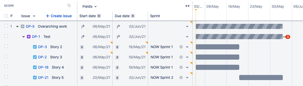

Thanks for confirming the version @David Lam, that sounds concerning - this might sound like a stupid question, but can you also confirm that the parent link is correctly set between those epics and initiatives?
Also, the inherited date won't show up in the same way that the sprint inferred dates do ... it will actually show up as a roll up symbol, see this screenshot for an example:
I'm guessing this isn't what you're seeing? The striped issue bars indicate that the dates are rolled up.
