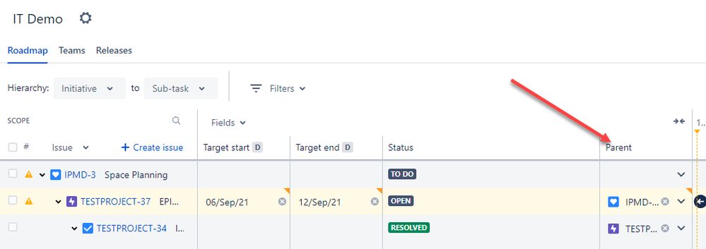

1) Go into your AR for Jira plan, and expose the "Parent" column to identify the the parent issue roll-up assigned value (See image below)

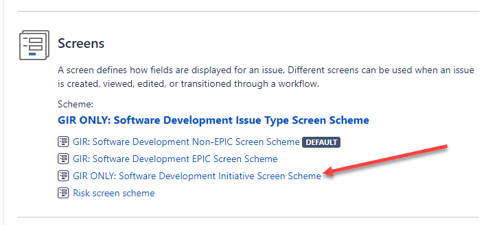

2) Go to your project where the issue is associated to and modify the screens configuration and add the "Parent Link" field for Epic or the higher issue types (i.e Initiative) only.  NOTE - it is important not to expose the "Parent Link" field to any issue type that rolls up to Epic.

Thanks for your update.   As I mentioned in my previous reply - You can adjust your project's Screens Configuration (where the initiative issue is hosted in) and add the "Parent Link" field to the Issue View screen for the Initiative Issue Type only.
If currently your Initiative Issue Type is sharing a common screen configuration with other issue types in the same project, then you will need to create a new screen configuration for just the Initiative Issue Type with the "Parent Link" field exposed.
Example - In one of our projects, we have Initiative and other issue types setup for the project.  As you can see we have created a custom screens scheme just for Initiative Issue Type, so we can expose the "Parent Link" field for this type.
If you don't want to go this setup, then you can simply create a AR for Jira plan, and add the "Parent" column in the plan.  This is assuming that you also include the project that has the "Program" issues in your plan.  From the plan, you can then see the Initiative to Parent association from it.
