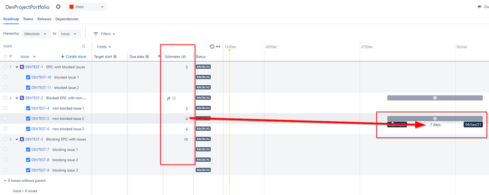

Issues manually dragged into roadmaps are ignoring time estimates
jbeg
December 17, 2020
When dragging issue manually in the Roadmaps view the original estimates and rollup estimates are completly ignored.
Is there a configuration that I am missing? How is this a useful feature if you have to adjust EVERY single issue afterwards to the correct timeframe?

Hi @jbeg ,
There is no connection between the estimate and the start and end dates when you are manually planning (however if you use auto-schedule then those estimates will be taken into account to suggest new dates).
It sounds like you're expecting that when you increase an estimate that the end date of an issue should automatically extend?
We made a decision not to create that kind of implementation because we wanted to allow the user to retain in control. There are many reasons why there might not be a direct correlation between estimate and dates - for example, an issue might not be worked on continuously, an estimate of 4 days does not necessarily mean that it will be completed in 4 days time if someone is only working on it in parallel with other tasks. Maybe the assignee only works part time or has a planned absence? Similarly it might be possible to complete a task in less time if it is possible for multiple people to work on it.
At the end of the day we didn't want to build too many assumptions into the planning experience that might end up frustrating users.
I hope this makes sense - very happy to discuss this further if you have suggestions or ideas about how you'd like to see this work though,

Hi Dave,
unfortunately, this makes no sense to me. The planning experience is frustrating as of now.
  • The auto-planning feature utilizes the estimates - so far so good
  • I do not expect the target/due date to change when the estimate changes - i expect to get a warning in the roadmap if the new remaining estimate is larger than the time until target/due date
  • It is not reasonable that the suggested timeframe in manual mode does not utilize the estimated time
    • it would be very helpful if the suggested timeframe matches the estimate. The user still has full control to change that. But using 7 days as a baseline for every issue is just bad design
  • Jira does not support working with multiple assignee on one task. This argument makes no sense regarding estimated and dates.
  • The old planning interface had an capacity view - this is completely missing
    • You mentioned parallel work - How can you see in the roadmap if an assignee has more work than his weekly capacity?
    • You mentioned part time work - This is not relevant for planning because the weekly capacity of the user already reflects that.
    • Why is there no warning when the remaining estimate is larger than the timeframe until target end/due date?
    • How can you plan for abscence of users or make the absence visible?
    • If not using the auto-planning feature, i dont see how we are supposed to see if an assignee can work on certain issues in timeframe x-y or if he is already assigned with too much workload?
The only thing you got right with the new planning interaface is the usability. But feature wise you made a huge step back. As of now, it looks to us that 3rd Party vendors like BigPicture or Structure offer a way more refined and feature rich plugin for less money than Atlassian is asking for Advanced Roadmaps.
