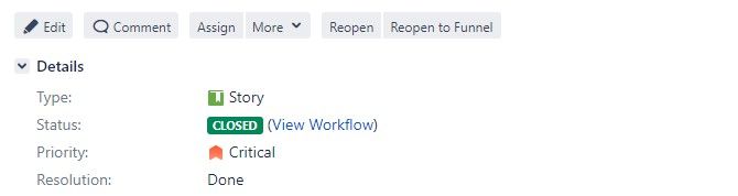

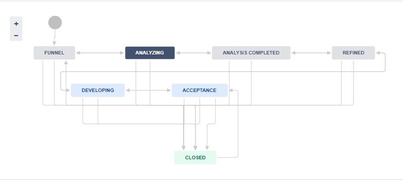

I have attached a screen shot of the workflow that we are using, it is custom, implemented by our Agile Coach / Team that has setup our environment.
I have attached a screen shot of the Issue Screen, I do not see the check mark you mentioned beside the "Done", does this mean we are doing something .. wrong?
So... are you thinking that the User Stories are not appearing due to them having in a Done status, and then moved back to an Open status?

Thanks @Mike Lemmon - I should have checked earlier, but are you using Cloud or Server? I'm guessing that you're using Server as I don't think you'd see that check mark on Server - my apologies for the confusion.
The main reasons why an issue might appear in the issue source but not in the plan are usually:
  • issue resolved for longer than the plan configuration allows (issues are excluded if they have been resolved for a configurable number of days - this prevents plans from growing out of control over time)
  • issue resolved without an resolution date (what I was suggesting above) - without a resolution date we can't work out how long the issue has been resolved for
  • issue assigned to a release, but the release not included as part of the issue source configuration (you can select which releases to include issues from during plan creation and issue source editing)
The other reason is that the issue just doesn't match the issue source, but you've said that you're seeing them so I'm assuming it can't be that.
I jumped to a conclusion earlier about the resolution problem, but you also didn't mention the status category the issues fell into (either to do, in progress or done) so I should have checked that first.
The other thing would be just to confirm that the issues are loaded but are hidden by some filter in the UI?
