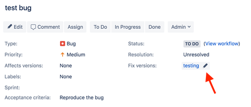

Once you have this permission, you can drag the mouse over to the fix version field and a pencil icon will appear to edit it:
If it didn't work, try to use a different browser or incognito mode just to ensure you are not facing a cache problem.
