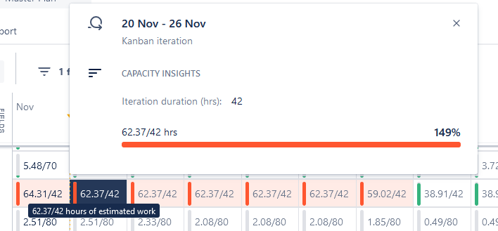

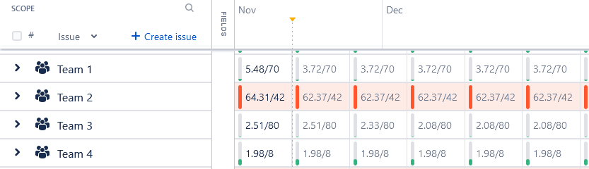

Currently when viewing capacity in a timeline, I can see the hours of a team's capacity (ex: 40/102 hours), but there is not an easy way to see which issues are contributing to that capacity. Ideally, I'd like to be able to hover over, or click the sprint and see what issues are making up the 40 hours...
Capacity Insights (clicking one of the sprints/releases) Seems like it would be a great place to either list all the issues or provide some actual... insight... into what is taking up the capacity.But unfortunately, it doesn't.

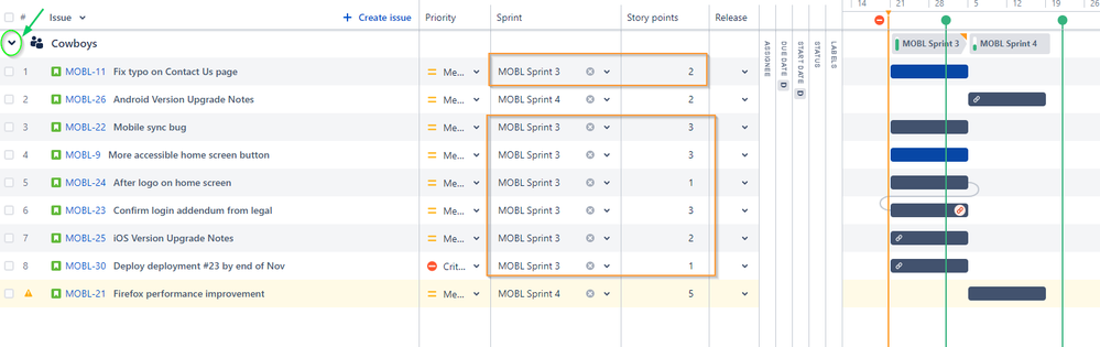

Isn't is as simple as clicking open the content of team 2 (for example), ensuring you have the Sprint and Hours fields displayed and review from there....or am I missing something?
See my example below, ok I've got story points, but you get the idea...yeah?
You could even filter by the sprint in question so that all you see is the sprint date you want to review.

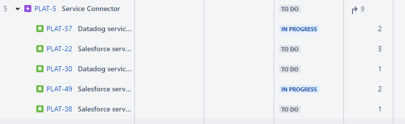

Do the teams use the Time tracking functionality in Jira? As that seems like the place to start.
If the Remaining Estimate field is used, then you can add it into the plan via the "estimate" field (as long as the Plans estimation type is not set to Story points) and set the view to "Roll up - Other" and you will get something like the below...and it will be up to date data......as long as the people keep their issues "up-to-date" regarding time tracking. In the example below, the stories have the time recorded in them, but the total is rolled-up into the Epic (it will go higher if configured) so 9 days left on this Epic. then it becomes a question of spread across how many people (as add the Assignee field)

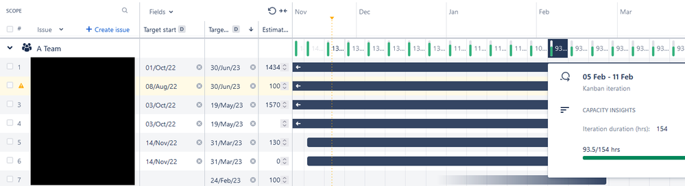

Yeah... we are using "Roll-up" functionality for the plan as we have gotten many teams to the point of creating Epics to break their work into some sort of feature sets. So we may have 3 Epics "Build X, Re-Configure Y, Train Z" and those hours roll up to the Initiative and than to our top-level Enterprise issue. So that's good.
I think the challenge comes in when a team is at 130% capacity for a period of time and one wants to reflexively use the plan to see, what is contributing to this "130%" .. it would be awesome to click a given week\month and see:
  • Build X - 10 hours
  • Re-Configure Y - 22 hours
  • Train Z - 15 hours
  • Other Thing A - 44 hours
  • Another Thing B - 30 hours
This would allow some quick, "why are we doing those things now? Let's re-prioritize"
