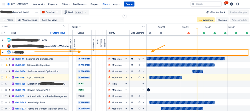

We have multiple projects in Jira that we report status on from a project level. When we view these company-based projects in our Adv Roadmaps Plan, we can only see details on epics or lower. Nothing seems to roll up to the project level. Is there a way to view this information at a project level?

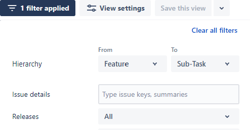

Finally, but most basically, How is the "From" and "To" configured in the plan/view? as if like mine below, then nothing above "Feature (Jira Epic) will be displayed until a change the "From" to filter them back in.

One suggestion here would be to create a new issue type called Project and create a custom hierarchy in Advanced Roadmaps.  You would then associate all epics to each relevant project, and then you could see the roll up.
https://support.atlassian.com/jira-software-cloud/docs/configure-custom-hierarchy-levels-in-advanced-roadmaps/

Hi Joe,
Thanks for this suggestion. We did make the change and this helped, but did not give us completely what we're looking for. Still tweaking though!
