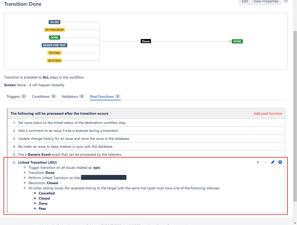

You can setup a post function on the transition to close an epic when all linked issues are closed. https://confluence.atlassian.com/adminjiracloud/advanced-workflow-configuration-776636620.html#Advancedworkflowconfiguration-postfunctions
Here's a screen cap of it configured.   You'll have to figure it on all of your workflows.  2019-06-05_9-36-42.png

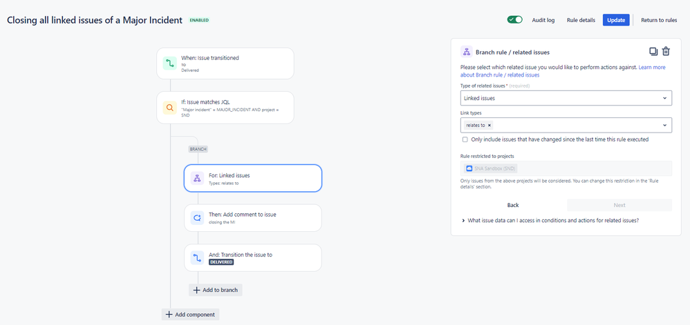

I know this post is an old one, but maybe someone looking for another way to do this, like I was, and crafted my own way to do this, when the issue being resolved (delivered) is a Major Incident, but the process can still be the same.
  1. Setup a rule that looks for a transition to the desired state/status
  2. A good idea to limit the spread of this based on JQL (in my case I only wanted Major Incidents and the tickets linked to them)
  3. Create a branch for Linked Issues (if you have a custom linked type for MIs then use that, at this time in my Sandbox, I do not, but I am considering this in production)
  4. I added a comment to each ticket (would want to inform the reporters that this is going to be closed/resolved and why
  5. Transition the issues to whatever status is fitting
