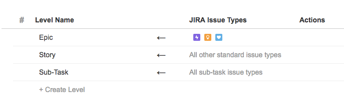

So how's your Portfolio Hierarchy Configuration configured exactly?  Can you post a screenshot that shows the Level Name and JIRA Issue Types columns from that screen in the admin?
Dale Cieslak
July 18, 2017
The orange and blue icons are the custom issue types that I want to behave as Epics, and everything else falls into the natural hierarachy:Screen Shot 2017-07-18 at 2.27.22 PM.png
Deleted user
July 18, 2017
Yea that's why it doesn't display them as you want them.  The hierarchy you see here is what Portfolio uses in the tree view, it doesn't use issue linking in that way.
I would follow the steps in the link from my first comment under the "How to add the initiative level cross-project" section, using the MASTER project as the one to store initiatives.  You can then use MASTER-1 as the Initiative and assign the individual issues under it.  When you select an Initiative in the Epic view, that should filter down to all of the issues under that Epic (or in your case those two custom issue types).  So CustomIssueType-1 has Story1, Story2, and Story3.  If you select MASTER-1 as the Initiative for CustomIssueType-1, it will apply MASTER-1 to Story1, Story2, and Story3 as well.

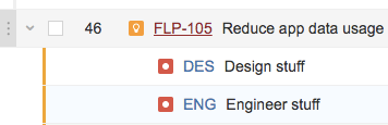

In the tree view, in Portfolio, I *can* create child issues, and they display properly (MASTER is FLP in the image here).
However, what I thought Portfolio would allow me to do is to add a project to the plan, with the hierarchy defined (via the Portfolio admin, and Jira issue links), and Portfolio would recognize the hierachy and display it.  It doesn't.

It does, just not in the way you are doing it via issue linking. It reflects the Epic/Story/Subtask hierarchy that you see in JIRA Software on Agile boards.
It does not, as far as I know, reflect "is parent of/is child of" issue linking.
Try committing one of those issues (Design stuff or Engineer stuff), it will create the issue in JIRA Software.  Open that issue in JIRA Software, are there any issue links there?  What is visible on the issue detail screen that shows it is under FLP-105?
