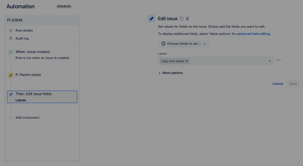

I've created two automations to sync parent/child issues and neither are working. One is set to copy the label field from parent to child on creation of the child: (I know it's currently disabled; it doesn't work when enabled.)

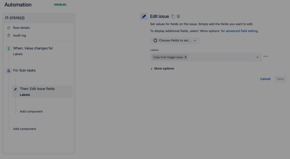

The other should update an existing child issue when the label field of the parent changes:
What am I doing wrong?

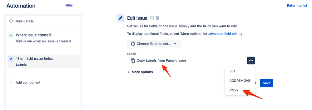

Hi @Collin Lemons
For your first use case (copy from parent when child is created), I would try it like this with the COPY action:
Collin Lemons
May 10, 2023
That fixed the creation automation! Thanks so much for the help, Michel!

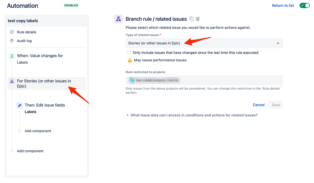

Michel Neeser
May 11, 2023
@Collin Lemons I checked the other automation too. The solution provided by @Himanshi works perfectly in general. But what you seem to have is a parent/child relationship on the epic level and not actual subtasks (I think this is what @Himanshi wanted to clarify in the comment below).
So, you basically need to change your automation rule to "For Stories" instead of "For Sub-tasks" like this:
Collin Lemons
May 11, 2023
That did it. Thanks again, Michel!

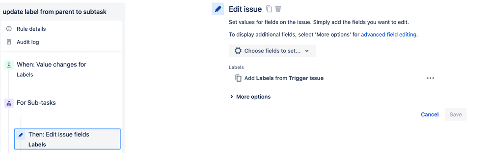

Himanshi
May 10, 2023
Hello @Collin Lemons ,
Welcome to community!
I have an automation rule setup where I tested the copying the labels from parent to subtask.
I am sharing the snippet for your reference , please try and test . This should work for you :
Collin Lemons
May 10, 2023
Himanshi,
Thanks for the quick response!
I believe I altered my automation to match yours, but I'm afraid it didn't work. When I check the audit log it says "Branch rule / related issues No related issues could be found." The trigger issue has a child issue, though. :(
