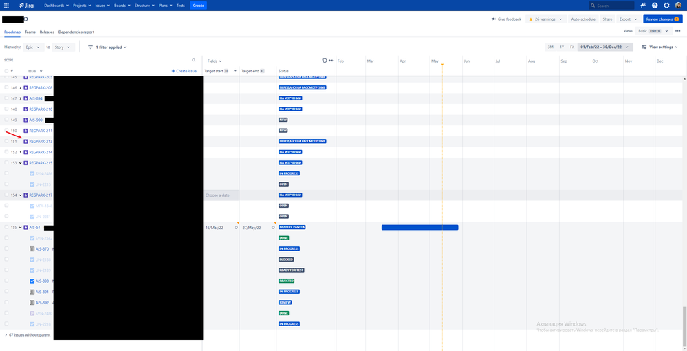

I can`t find the way to see my Epics with its sub-tasks on my Roadmap. Epics are in 2 different projects. Also epics includes tasks from 4 different Jira projects.
Is it possible to see full hierarchy Epic to story if the stories are in different projects?
Steps:
1. Make filter "project in (A, B, C. ..)
2. Make a Board using the filter. Share all the projects in my Filter Query.
3. Make my Roadmap. Issue sources is my board. Filter on Roadmap by project (2 from all)
4. Looks good but I am trying to group by project to put in order.
Problem: Now under each epic I see the only tasks with set projects in filter.
Is there some way to avoid it?

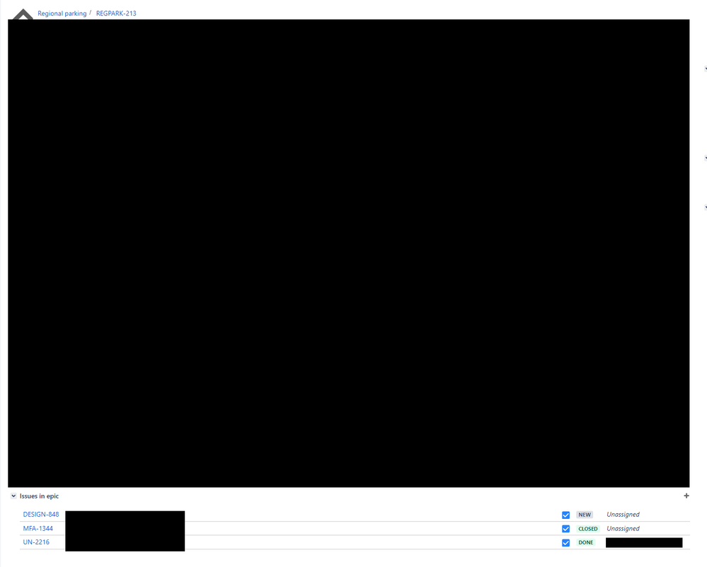

I want to see epics from 2 project on roadmap and its tasks from 4 another projects. Now looks like it work but I can`t see all task under epic. Some of it did not show. For example, Regpark-213 doesn`t have tasks at all. No filters for status is activated.

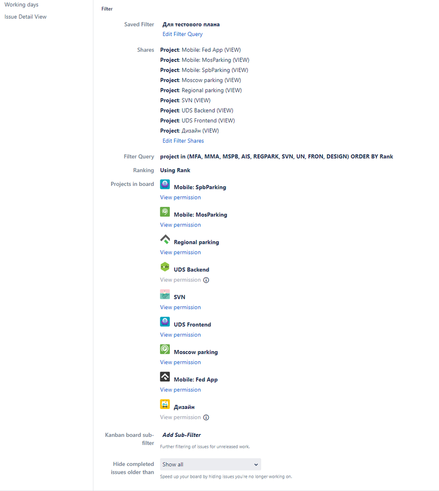

Does the board include project DESIGN, MFA and UN?
Can you share the issue source of your plan of the filter query of your board?
Mister Twister
May 13, 2022
Yes, it does.
