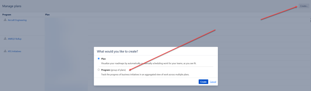

Ok, it seems you are referring to DataCenter (server) env and not Atlassian Cloud env. If this is correct, then you can click on the "Create" button when you access the "View Plans" option under the "Plans" menu option from the top nav menu bar.
You will be able to see there is an option for one to create "Program" to group different plans together.

I'm not entirely sure which environment we're using, but we do have the option you displayed in your screenshot, so it seems like we may be in the Data Center environment.
That said, my plan was already created before I became aware of the Program structure. I’m now trying to add an existing plan to an existing Program, rather than doing it at the time of creation.
Is there a way to do that after the fact?
Yes, you can. Go to Manage Plans in Advanced Roadmaps and click on the Program you want to add the plan to. On the Program screen, click on the three dots next to the program name, and click Configure. There under Source Data/Connected Plans, you'll see a list where you can check a checkbox next to the plan you want to add. If you don't see this option, you may not have appropriate permissions on the Program to do this and will need to talk to the Program owner.
