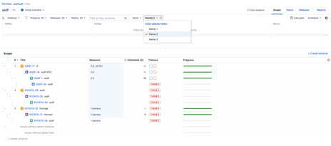

To filter on the themes there is an option under the more drop down menu at the top of the plan:
After Selecting the Themes Filter option, you can select the desired Theme filter and hierarchy level to see all the issue linked to that particular theme:

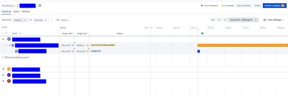

Thank you for the response. Which version are you using? mine is not even similar.
2019-07-03 09_26_13-CTO Portfolio - Portfolio for Jira - JIRA Dev _ SITS - Test02.png
Do you show there the plan or the program? How can i make a similar view as the plan view in the program? Is there a way that users can see the plans?

Hi Paula,
Thanks for the screenshot, and your on the New Planning Experience (Portfolio 3.0+) and that lines up withe the the second portion of my reply where the theme functionality is currently removed from the new experience, in favor of other grouping and coloring options.
Check out the articles I listed in the last comment for the current functionality in the new experience, but also check out the following Discussion post where Rhys Christian our Portfolio Product manager goes into some detail about the future plans for themes in the new experience, where this is on our roadmap to add back into the new experience from various user feedback loops on the functionality:
But if you need this functionality currently navigate to the plan configuration settings menu, and under "Planning Interface" you can choose to disable the improved interface to swap the plan over to the Live Plan view, You can also choose to switch back and fourth between the planning interface views as much as you like noting a re-calculation / auto-optimize is required between each switch so the schedule will update to a current data alignment with the jira issues based on the additional settings in the plan configuration.
