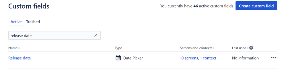

Check the setup of the Deadline and Release Date fields - go to Admin -> Issues -> Custom fields and find the field, then click "edit" next to it.  Check that there is a "searcher" set on the field.

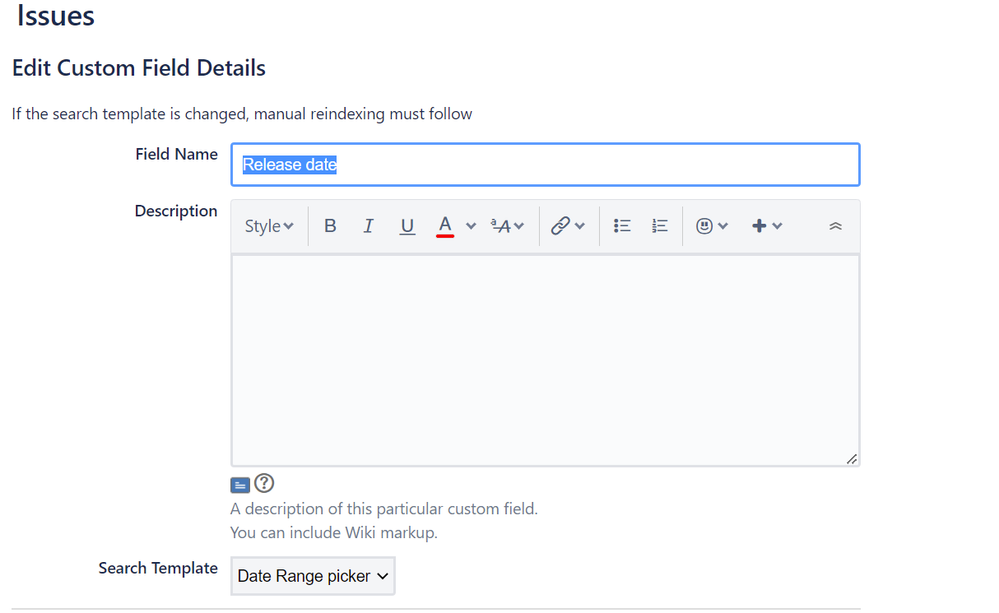

I checked but I didn't find any "searcher field".

Sorry, I can never remember exactly what the phrase is for lots of things in Jira.  The "Search Template" is what we were looking for when I said "searcher".
You've got the one I expected set for Release Date, so that is not the problem.
