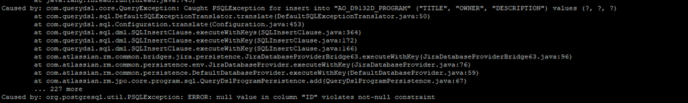

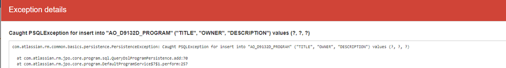

When i try to create a portfolio i get the following error
reading the logs (atlassian-jira.log)
Why my id will be arriving null to base data?

It looks like we're trying to write a null value to the ID column in the program table. This is interesting because the ID column should be managed automatically by an auto-incrementing sequence in Postgres, we don't generate the ID value in the Portfolio code itself.
I suspect maybe Portfolio hasn't installed properly and the database schema has been left in an invalid state? Is this something that only started happening recently, or is this a new install that isn't working correctly? I'd like to check the start-up logs to make sure Portfolio has installed properly.
