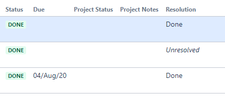

In the Portfolio plan, we get to see the issues with status"Done" and Resolution "Done", But the ones with Status "Done" and Resolution - unresolved (since there is no post function set and there is no way to update that field) are not appearing in the plan.
Though the status is Done under different Jira Projects, in one of the Project where the resolution is "Unresolved", those entries only don't appear in Plan. The other Done-Done issues are appearing in the Portfolio plan.

@Nivedita R - One thing that you should look at your board to ensure the last column contains your terminal status for issues (where you are sourcing from in your plan).  In general, if an issue is "DONE" meaning resolution field is not NULL, then it will drop off from your plan by default.
In your ask - "ones with Status "Done" and Resolution - unresolved", this is an critical issue of yoru WF in your associated project where you need to look at the post function of the issue transition into the DONE status because you should not have any "DONE" issues without resolution being set.  You need to fix it in Jira.

2. The other question is about Portfolio. What is the basis for it to show the issues? How is that the issues from other projects with status and resolution as done is still appearing in Portfolio plan while the closed / done ones from my project is not coming though (incorrectly) the resolution remains as "unresolved".  Should it not be the other way? If there is a proper resolution, it would not appear in Portfolio. Is the visibility in the plan determined by the status or resolution or any other field ?

The closed ones are appearing in the last column in the Kanban board and the Plan is based on that board.
Using Post Functions, I have now set a proper value for the resolution field for the issues in status called "Closed" which is one of the DONE statuses.
But still for one of the Jira project, these Closed issues are not appearing in Portfolio plan while in the same plan, for the other Jira projects, the Done issues are visible.
