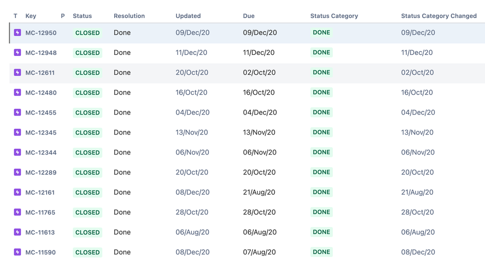

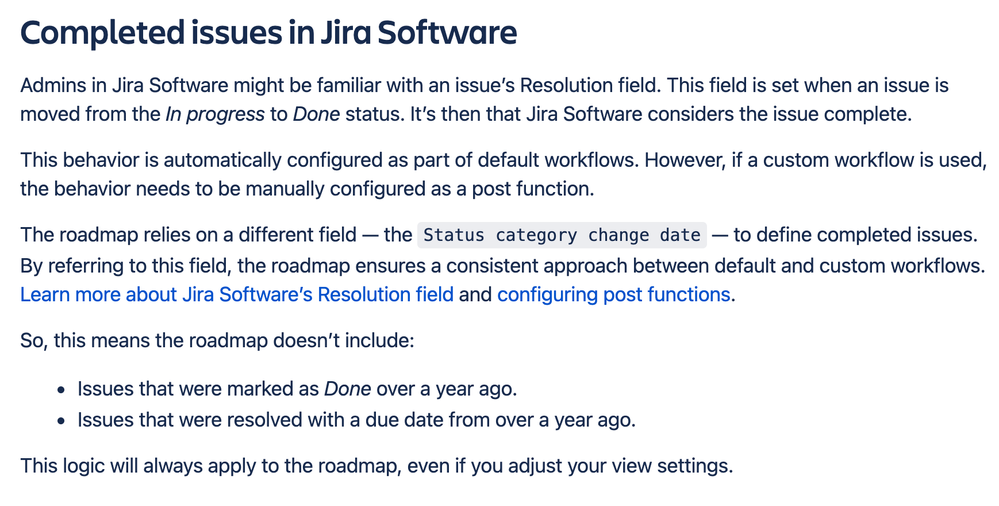

Simon Godard
December 16, 2020
Same problem here. We are using Roadmap BETA with Classic project and as soon as we mark our Epics as Done and change their status to Closed, they disappear from the Roadmap view.
We tried to follow the guidelines here 2020-12-16_12-38-12.png2020-12-16_12-47-08.png
