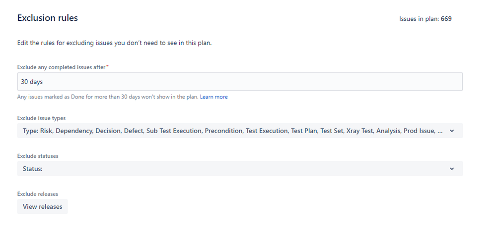

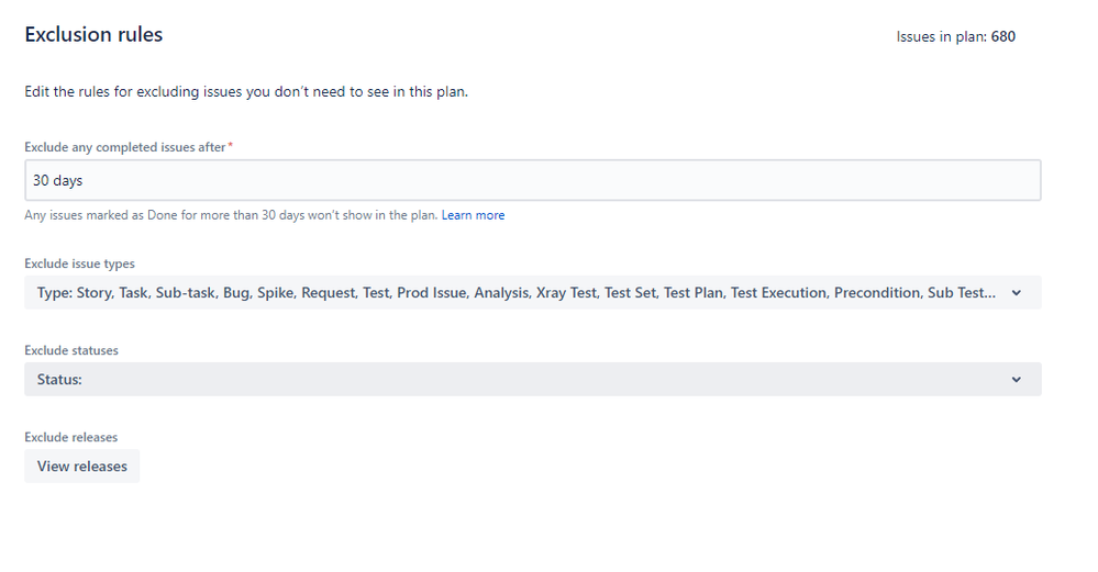

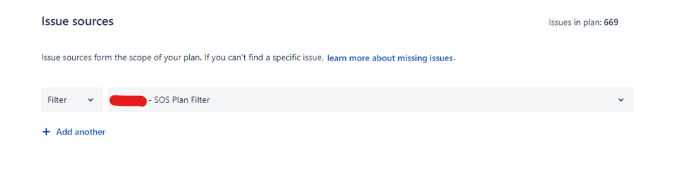

Hey Joseph,
I'm comparing the issue count side-by-side between the 2 plans on my own PC with my own jira account.
  • The missing issues are initiatives. I have project admin rights to both projects in question (669 vs 680 count)
  • Issue sourced from the same filter
Plan 1 Issue Source

Plan 1 Exclusions
Plan 2 Exclusions

Hi Joseph,
It's now fixed.
For whatever reason, the plan had the missing issues excluded - it was sitting in the "Removed issues" tab. I had to re-include them.
I'm the only administrator of the plan and had never manually excluded them myself.
This is after checking the "removed issues" tab multiple times over the course of the day too.

Excellent.  In general, you should consider the following checks in your situation (you are the only plan editor for the plans):
  • Ensure your users have access to plan's issue source content
  • Validate the exclusion rules
  • Checked the Removed issue option in the configuration (I was going to offer that as an recommendation to you based on your initial feedback.  Glad you discovered the error.
Here is a link for troubleshooting missing issues in a AR for Jira plan - https://confluence.atlassian.com/jirasoftwareserver/troubleshoot-missing-issues-in-advanced-roadmaps-1044784180.html
