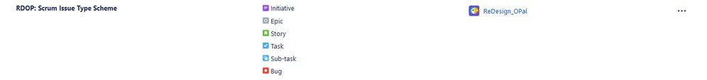

I assigned the issue type to the issue type scheme of the relevant projectIssueTypeScheme.jpg

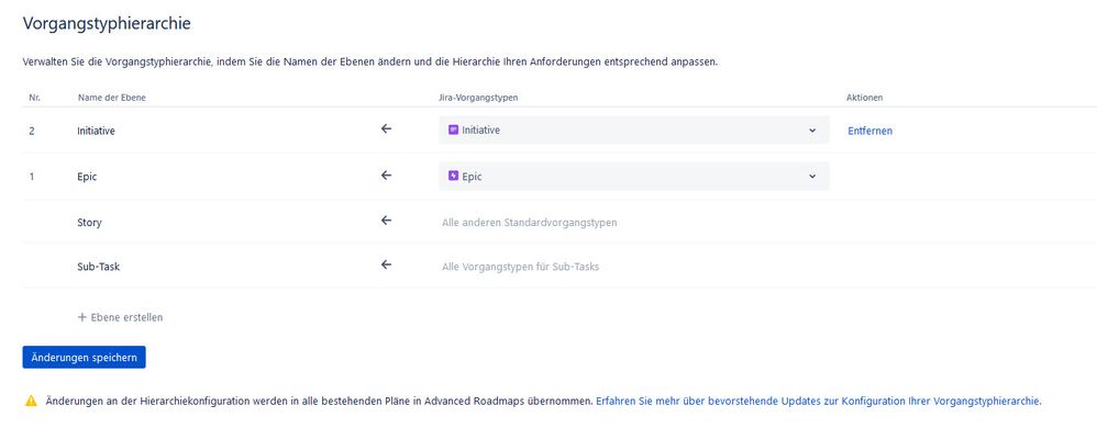

I added a new Issue type hierarchy with the new "initiative" issue typeIssueTypeHierarchy.jpg

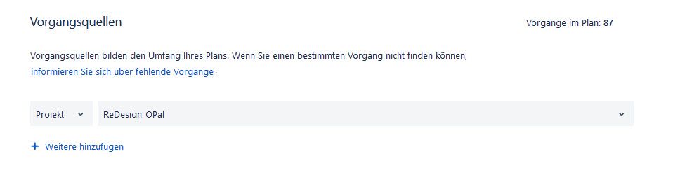

And in the advanced roadmap, this project is linked (it's the only source in this case)IssueSources.jpg

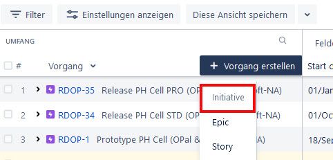

Now, when I click "create issue" in my plan, the new "initiative" issue appears, but is disabled.CreateNewIssueInPlan.jpg

Hi @Felix Klaes - Roadmaps default to Epic at the highest level so you can only create epic and below.  All you need to do is click Filter and under hierarchy, change the From issue type to Initiative.  That should do the trick.

thank you very much for the fast help. That fixed my problem. Now everything works as intended.
