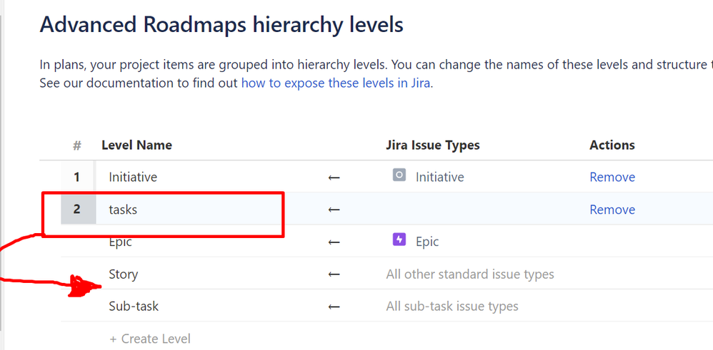

Hello,
I would like to change the hierachy levels in the Advanced Roadmap.
My goal is to add the tasks under the stories (instead of sub-tasks).
For some reasons I can move the "task level" only under the "initiative" and I can't drag and drop this field under the stories.
Could you please help me to understand why thishappens?
Nic Brough -Adaptavist-
February 22, 2022
The hierarchy in Advanced Roadmaps is for the levels of Epic and above.  It does not change the standard Epic -> Issue -> sub-task in Jira Software.
All you can do here is make your "task" issue type into a sub-task type, where it will work alongside (not above or below) the existing sub-task type.

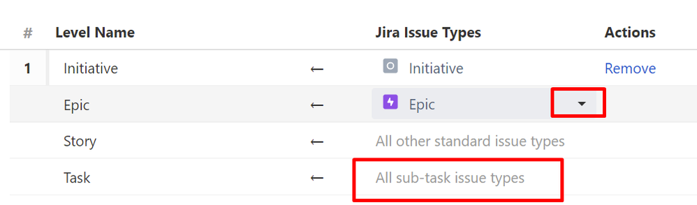

Sari
February 22, 2022
Hi @Nic Brough -Adaptavist-  thank you for your reply!
I tried that as well, but I don't have the option to select the tasks instead of sub tasks.
I can see the drop-down menu for initiative and epic but not for story and task / sub task

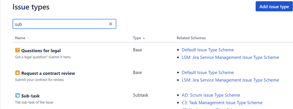

February 23, 2022
That's because you don't do the change from here, you have to change the issue type in the issue type lists.
In fact, you can't convert them.  You'll have to rename "Task" to something else (temporarily), then create a new Issue type called "Task", selecting the sub-task level for it instead of issue level.
Sari
February 24, 2022
Hi @Nic Brough -Adaptavist- , thank you!
I didn't get where I should change the issue type. From here?
Thanks
February 24, 2022
Yes, that's correct.  You'll need to add a new subtask type for "task" after renaming the existing task to something else.
