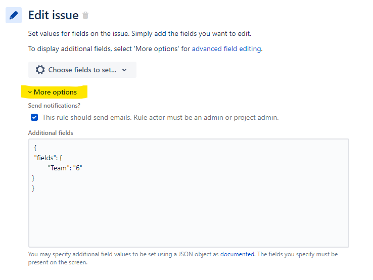

Hi @Olga Kolov
Go to the more options section of the Edit issue action. Then set it up as per the screenshot below. In this example I use Team 6.
You just need to know the ID of your team. Procurable via JQL using
 "Team[Team]" =
not just
Team =
that way, you can type your teams name and JQL will change it to the ID for you.

Hello @Curt Holley , thank you for your reply!
But I want to configure the trigger if this field bekomes the Team = 6 then do it... And in this case, I don't have possibility to enter the additional fields...
Or I don't see something important? ;) Sorry, I have changed the layout to english, but the Automation App is staying german.
Kind regards, Olga

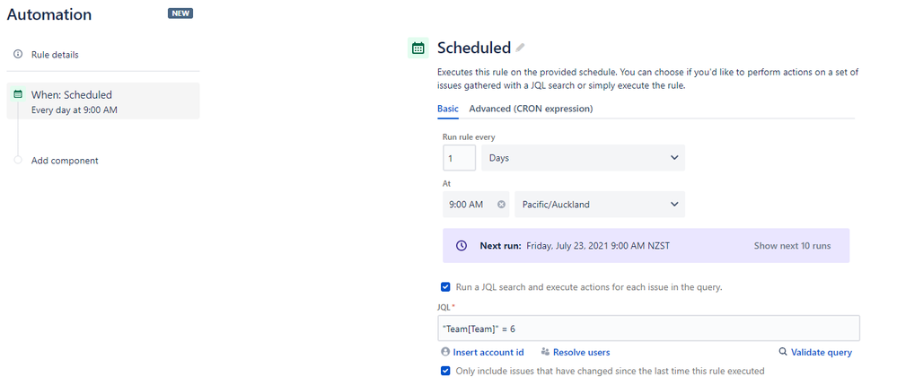

Curt Holley
July 22, 2021
Right.
Perhaps doing via a scheduled rule using JQL is the best bet. Not real-time/ideal, but a means to an end??

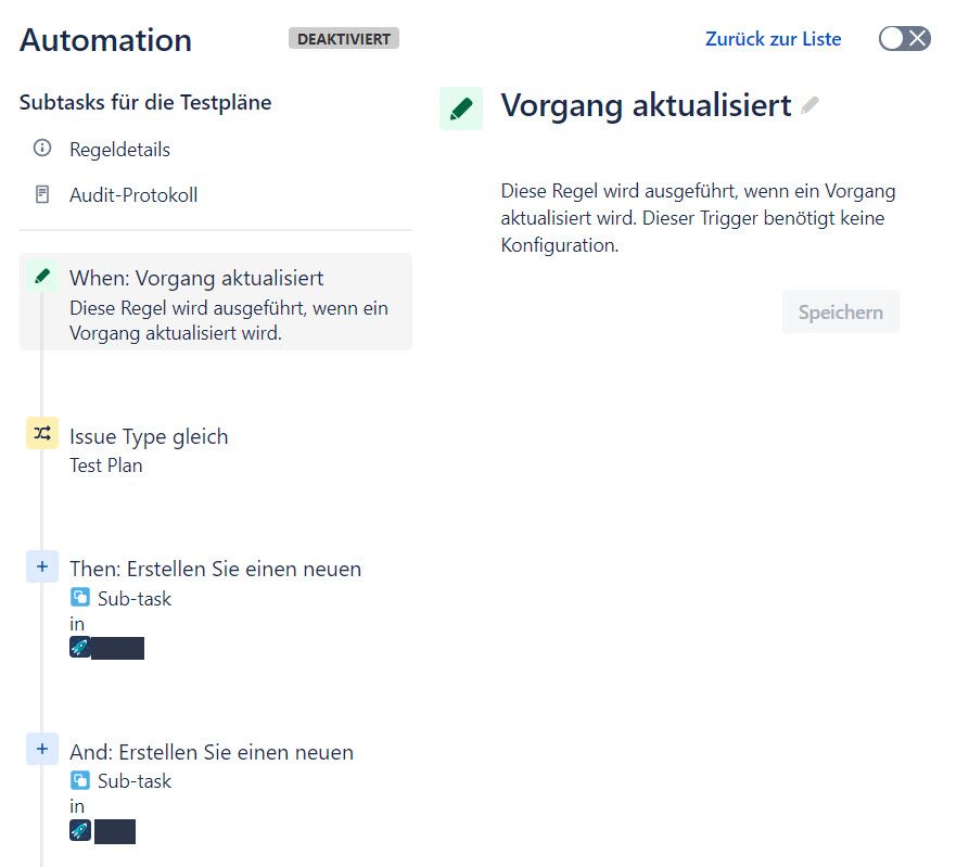

Bill Sheboy
July 22, 2021
As an alternative, you could try the generic Issue Updated trigger and add an Advanced Compare Condition to check the Change Log for the team value change.
