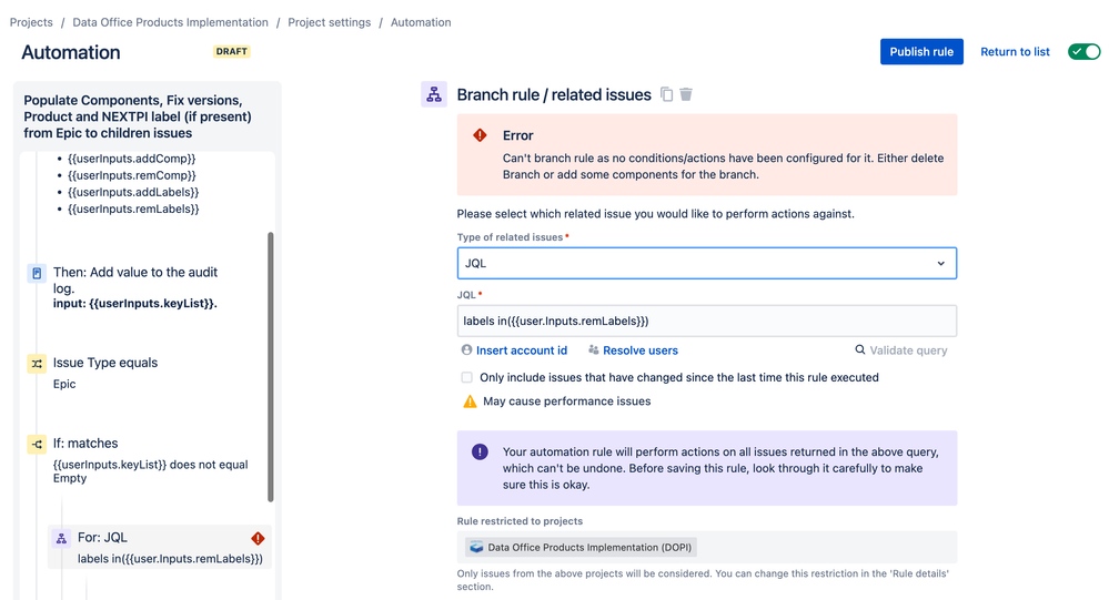

I have used smart values in other JQL-related actions, but for branch rule / related issues I can't:
Am I doing something wrong, or is it a limitation in this case? I haven't read any limitations that restrict using smart values in this context. If so was it reported? Thanks
Hi @David Leal ,
Going from what the error says, you may have missed out on adding a Action/Component after the JQL branch. I tried a similar configuration at my end got the error :
@Jehan Bhathena correct, that was the issue, I was looking for some more complex errors related to the smart values, without looking at the obvious.
