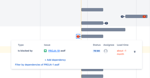

Thanks for reaching out, in the Live plan view (2.X versions) the dependency values would alter the order when you calculated to update the scheduling algorithm post change (Details on how the algorithm was weighted in live plans here),  and in the new planning experience, the dependencies will be flagged in the current location, Blue for no violation and red meaning that an issue is scheduled before it should start, prompting for a manual adjustment.
However, the error you are encountering seems to be occuring at the auto schedule portion, as the auto schedule should push out the dependent issue after the issue it is dependent on unless there is other criteria preventing the move.  Details on the Auto-scheduler calculation behavior can be seen here.
My suspicion is that there is another item such as one issue being added to a open sprint or future sprint or set release date preventing the auto-scheduler from adhering to the dependency so that it errors and requires a manual review to make a decision on which criteria is needed to complete.  But as covered in the auto-scheduler document linked above the criteria to look at are:

As an exe in the following screenshot the Issue scheduled before PROJA-19 is in the current active sprint and then the PROJA-19 issue is added to a future sprint without parallel sprints enabled so the dependency is skipped in the auto schedule to prevent causing scope creep by moving an issue in an active sprint to the next sprint, flagging the issue for further manual review to see where the conflict exists.:
