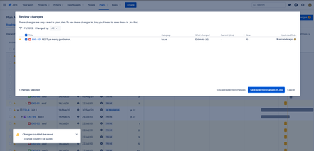

However, you noted not being able to review the changes either.  Is the Review changes option greyed out or are you getting a "changes couldn't be saved" warning when reviewing and saving like this:
If you're receiving the error like the screenshot that would indicate that you are missing a project permission required to make the change like schedule issue, edit issue, or manage sprint.
