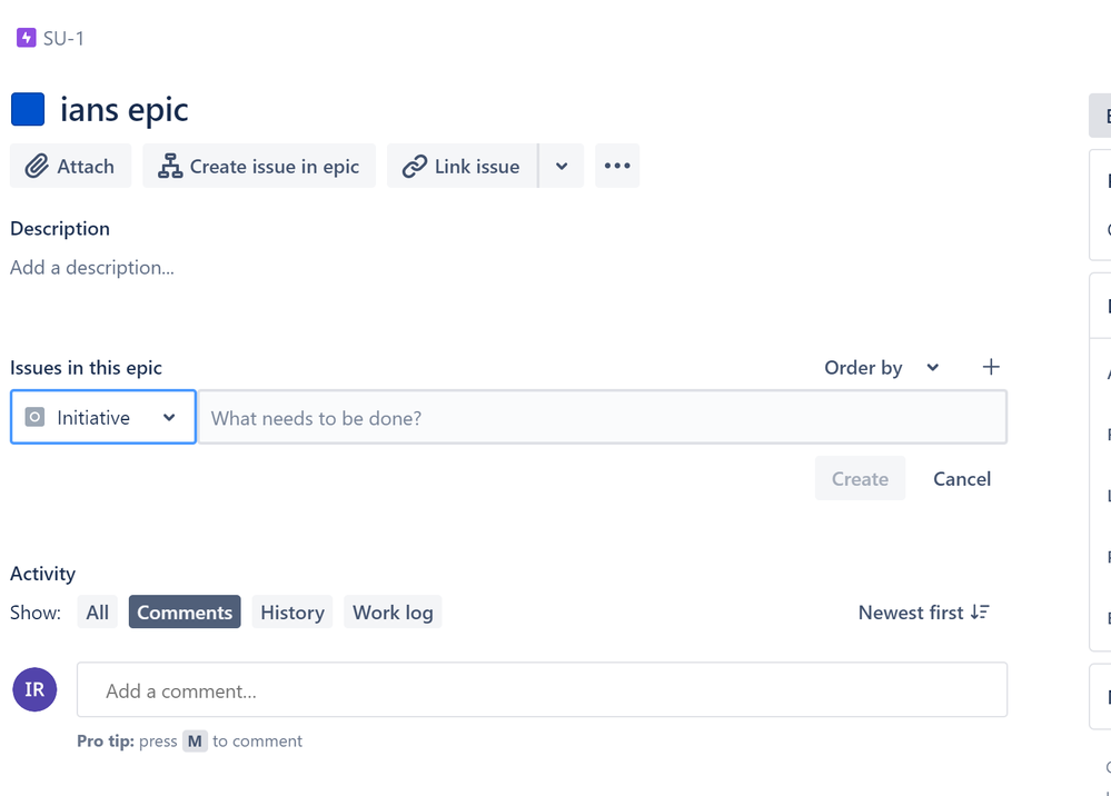

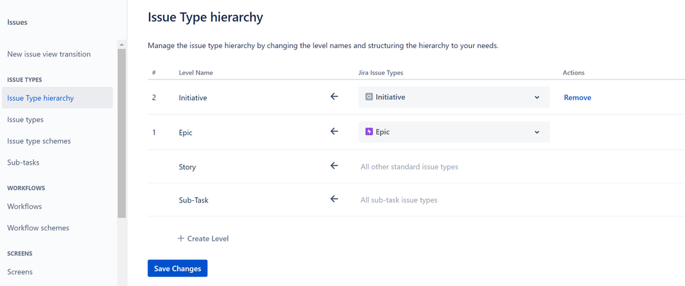

I've recently installed Advanced roadmaps and added an Issue Type "Initiative".  I have added the Issue Type "Initiative" to my Project Issue Type Scheme.  I then go into the Issue Type Hierarchy in Advanced roadmaps and add the level Initiative above Epic.  However there is number in a column called "#".  The number next to Epic is 1 and the number next to Initiative is 2.
I was hoping to create a hierarchy of Initiative->Epic->Story and expecting that I would be able to add Epic issues as child issues in the Initiative, in the same way you can add child issues in an Epic.  However, instead when I add issues to an Epic, Initiative is an option as a child of an Epic but I want that to be the parent of the Epic not a chile.  How do I create Epics as a child of an Initiative.issue type hierarchy.pngepic.png

Ian Rees
May 18, 2022
Do you mean in the "Issue Type hierarchy". I can drag the newly created Initiative level but can only drop it in its position back at the top above Epic, Story and Sub-task.  The number on the left in the '#' column is always 2.

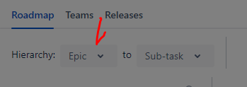

In your plan, check that your hierarchy is filtered to show Initiatives. Under the plan name, click on "Filters" and the first filter should be "Hierarchy". Check that "From" is set to "Initiative".
