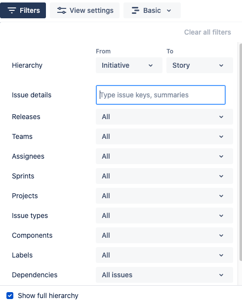

Hi @Matt Cechini ,
I would suggest starting with this document, it explains a few reasons why issues are not shown in a plan.
If it doesn't help, look at your View settings filters and verify that no filter is enabled.

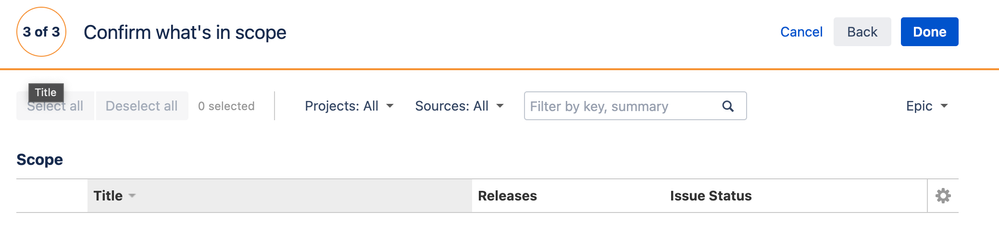

Matt Cechini
December 30, 2022
@Sara Hekmat I looked through that document and only some of the items apply as I'm not even seeing the items in the configuration wizard. Below is what I see... nothing.  I'm using my project as the source, so I assume _something_ would be visible.
I did have to turn on visibility of the "Fix Version" field, but that seems to have not done anything. Note that I did not perform the full re-index as it suggested.
Note also that we have no releases in use here.
Matt Cechini
January 3, 2023
well the answer seems to have been that I needed to run a re-index after changing the visibility of the "Fix Version" field.  I can now add items to the plan.
