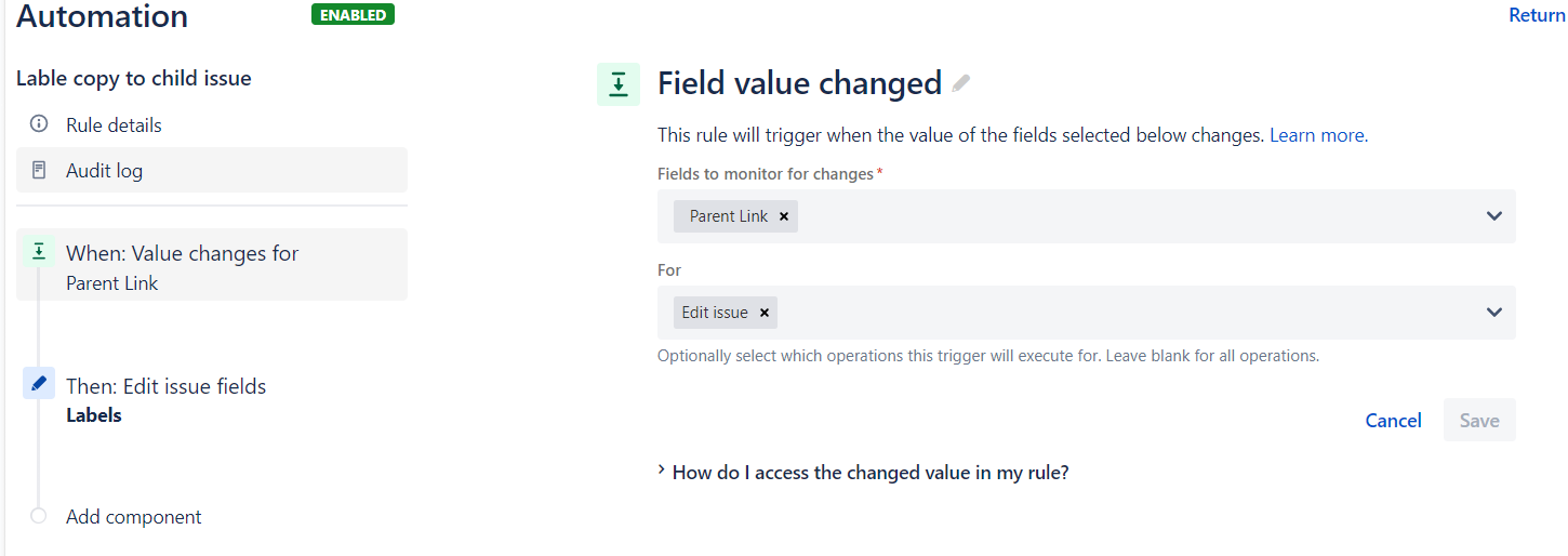

i have a question on rule automation.
Our teams works a lot with the lables and also subtasks. Whenever we add a task to a parent we would like to have the lable of the child to be filled with the lable of the parent.
As within the Rule automation i could only find one parent I used it but the rule itself does not work.
Below you can see my current rule which does not work...
Does anyone here has a similar issue / solution?

Lisa Grau
July 16, 2021
Hi Friedemann,
your automation should actually work, can you show me your settings in the edit issue action?
I recreated the automation like this (sorry for the german text, explanation below):
I used the same trigger and action as you did, selected "copy value from issue" and used the parent issue (= Übergeordneter Vorgang) as source.
It works just fine for me!

Lisa Grau
July 16, 2021
Okay, that works, too.
In this case I'd suggest to set the trigger to Value changes for Parent Link for [all operations] and not restrict it to "edit issue".
The restriction will only change the label when the sub-task is edited, but (if I got you right) you want to change the label also when the sub-task is created.
Since editing and creating are two different operations, your automation rule will only trigger when the sub task is edited after creation, not during creation. That should explain why the rule doesn't even fire.
Friedemann Wagner
July 16, 2021
mmh almost.
i have the feeling that "parent link" is not the right element? What you can see in the action log is that the action is successful but the linked issue although the parent link looks good to meimage.png

Curt Holley
July 16, 2021
If you are talking about sub-tasks of Stories, then it is the Parent, not the parent link field (which is used for the hierarchy above a Jira Epic).
You can have labels from a parent copied into its children (sub-tasks) via a post function in the workflow itself.
