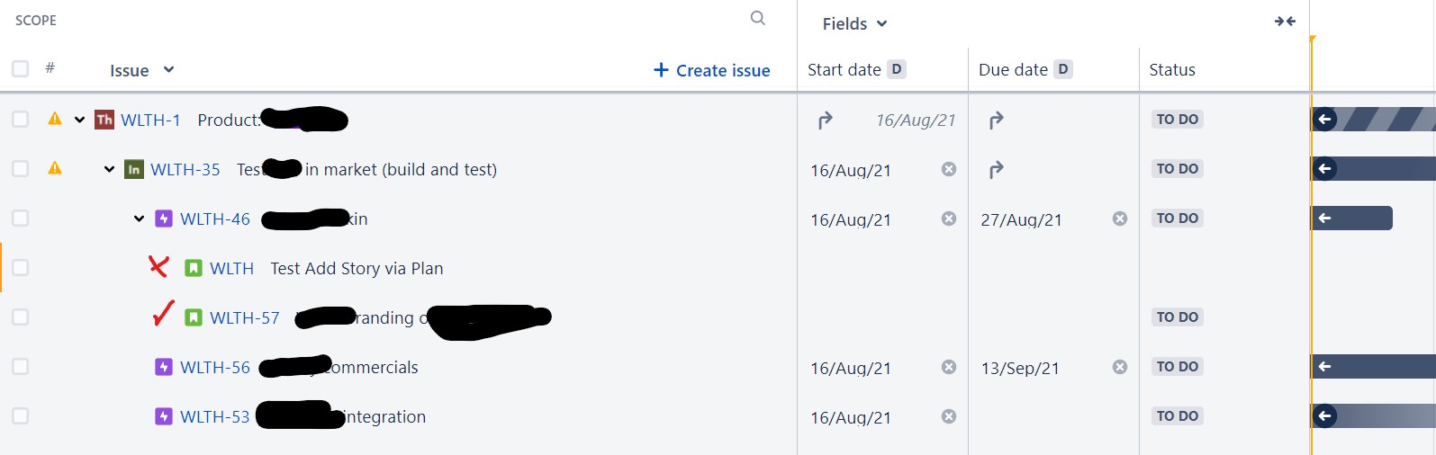

We have Advanced Roadmaps working
however, when we try to create a Story from within the Plan, 'something' is created that looks like a Story, but is essentially just the project ID i.e. in this case 'WLTH' , but no Story ID
in the screen image you can see that a story with ID = 'WLTH' is created
we can create Stories from within the project as is typically the case, and they are then reflected in the Plan correctly e.g. 'WLTH-57' as below
the correctly created Story can be seen in the backlog, but no the 'incorrect' one
I noticed this also happens with Epics, and may be the same for other issue types
Any ideas :-)
Cheers
Warde
Solved! Go to Solution.
Hi Warde,
The issue updates you perform within a plan are not saved in Jira until you commit the changes through the “Review Changes” Dialog box. This includes issue creation as well. So if you wish to permanently create an issue, make sure to select the desired changes and commit them in Jira, which will display the issue ID as you expected.
