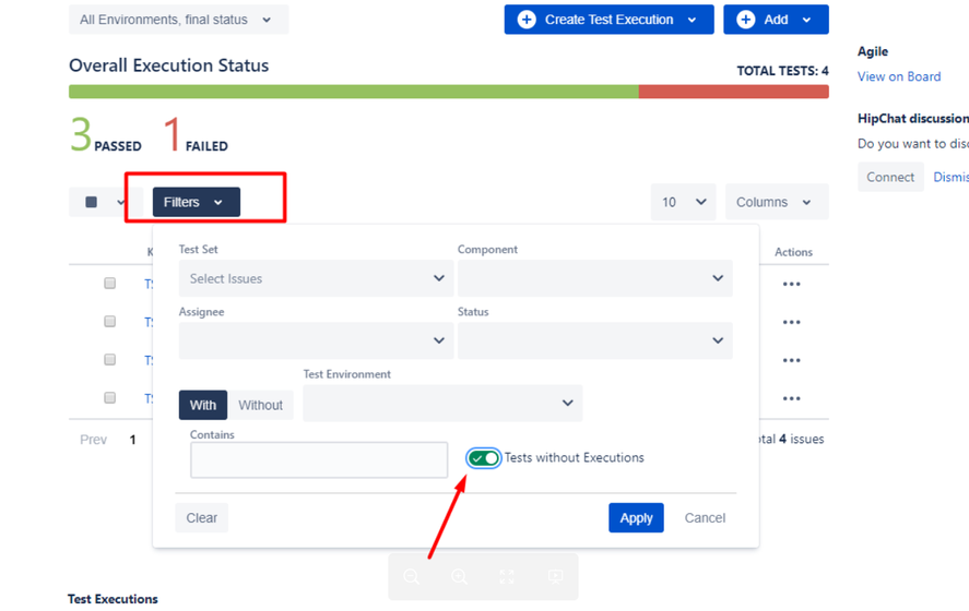

Hi Cristina,
You can use the Filter to show you only the Tests without Executions, like you can see on the following screenshot:
Best regards,
Xray Team
Hi Inês,
Thanks for your suggestion, I will try it, even though it seems a bit cumbersome. To be able to filter test cases without test execution, I will need to create a dummy test plan, add all my test cases and add all my test executions; and then filter. Once the test cases are identified, then I can delete the test plan again.
Nice functionality to have in the future would be to be able search test cases linked to at least one test set :-)
Best regards,
Cristina
Hi Cristina,
Thank you for your suggestion, we will take it into account!
Best regards,
Xray Team
I am using X-Ray also, but I do not see a Filter option for toggling on/off the "Tests without Execution". How do I add that option?
Hi @Truman Chau
The option has a defect and may disappear; we are working to fix it very soon.
Whenever there is any issue with the product, please contact the Xray Support (http://xraysupport.xpand-it.com) so that we can take care of it.
Kind regards,
Rogério Paiva [Xray Support Team]
