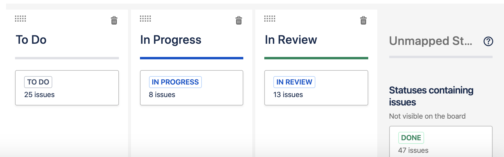

When the column view is arranged like this:

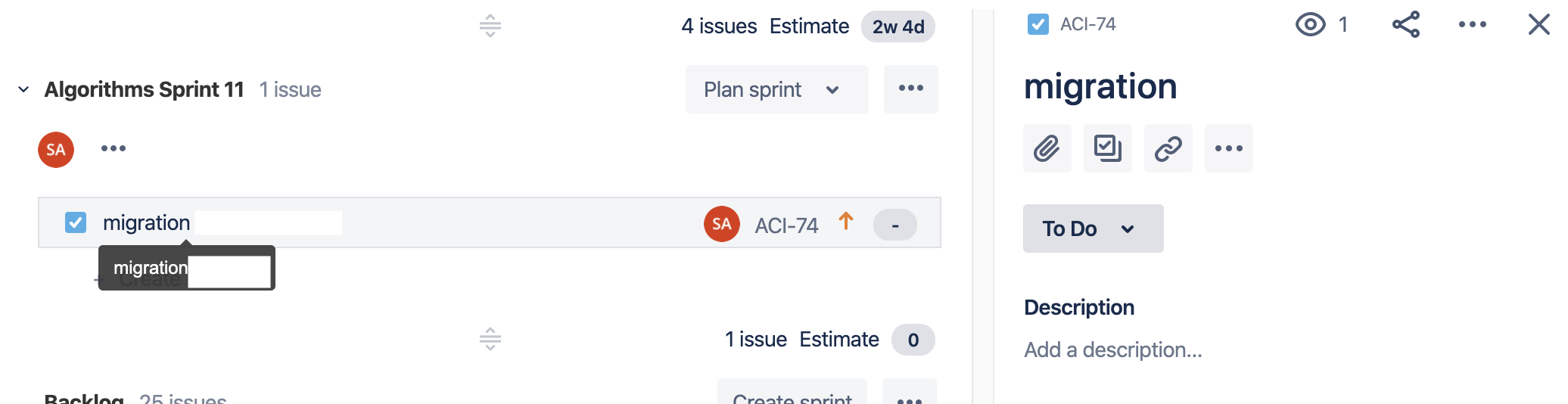

My backlog view only shows a subset of cards (those that aren't In Review) like this:

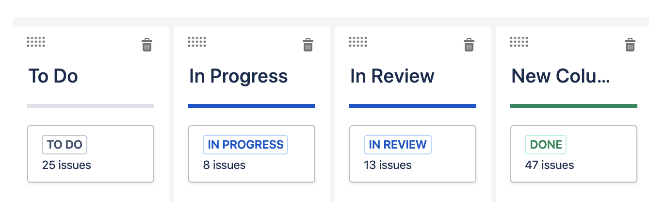

However when I have a fourth column with the Done status in it, like this:

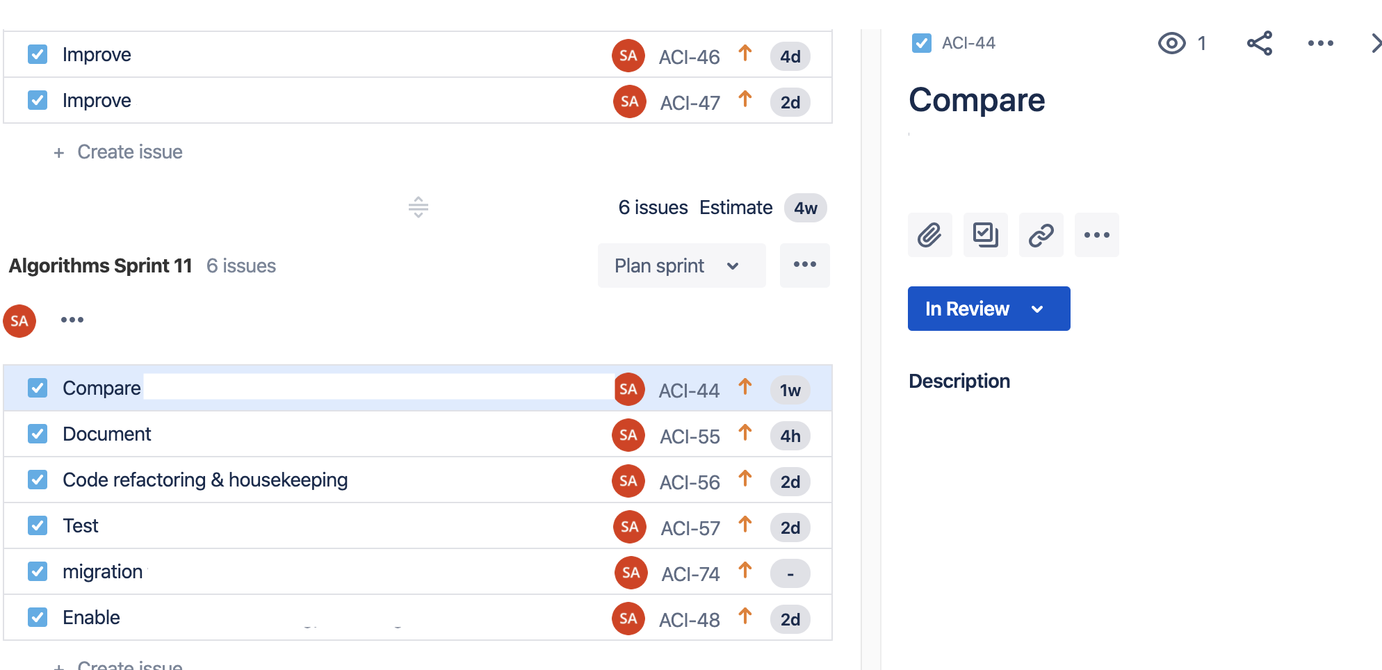

Then the backlog/sprints show all of the cards, including those In Review:

So when you end a sprint, all in review issues disappear from the board, right. Since in review status is placed at the right most column, this is expected.
When completing a sprint, issues at the right most column is considered as completed, despite the status of the issues, and it wouldn't appear on the board. You can confirm this by checking the sprint report
This is explained on this KB - https://confluence.atlassian.com/jirakb/how-does-jira-agile-decide-when-an-issue-is-complete-for-reporting-purposes-779158578.html
