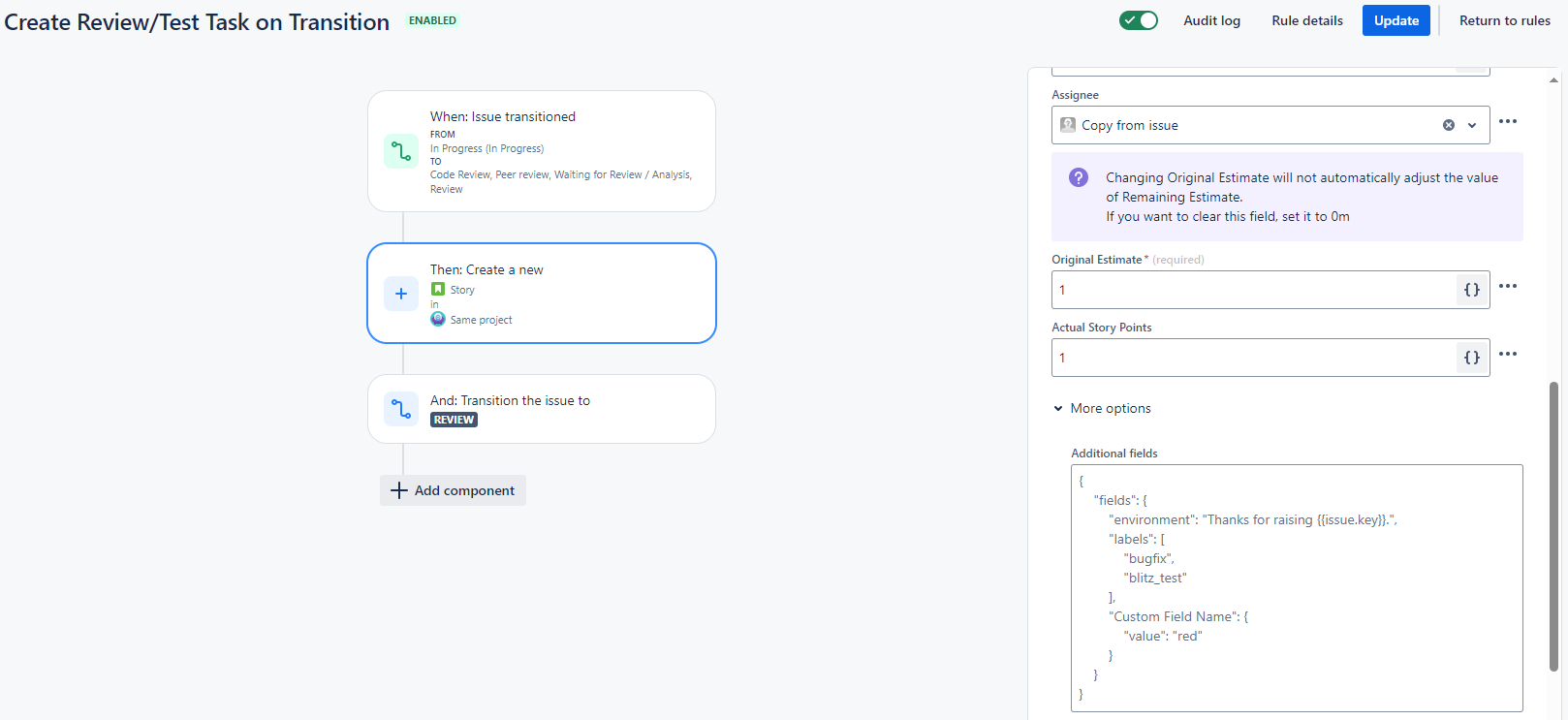

I'm trying to do something that should be very easy but it seems that Jira is making it frustratingly difficult to.
I have created a Task Creation Automation that when a story transitions from In Progress to In Review I want Jira to create a new story and assign that new story 1 story point.
The story creation works fine but for the life of me I cannot get the automation to assign 1 story point to the new story. The new story is created fine but the points are not set.
How does this need to be coded?
You can see in the picture below on the right, I have set Original Estimate to 1 in the box and Actual Story Points to 1 as well but when the story is created, no estimate is set. This is so not obvious. I don't know if I need to put 1 in the box or {1} or some other format.
Any help would be appreciated.

Perhaps let me explain differently. I have an automation that has two steps. The first is when an issue transitions from In Progress to Review, then I want an automation to create a new story. This part does work. In the Then: Create a new story in the same project I can see on the right hand side:
I've added in the rule Original Estimate and Actual Story Points and set them to 1.
Now for some reason, the new task is created correctly, except the Original Estimate and Actual Story Points in the new task created are blank.

Under the More options there is an additional fields section that has a bunch of text in it (see below). Am I correct if I say that I need to put "code" in this section to set story points of the new task I'm creating, perhaps something like, {"Story Points": {1}}
Here's the text in the additional fields section I can see:
"fields": {
"environment": "Thanks for raising {{issue.key}}.",
"labels": [
"bugfix",
"blitz_test"
"Custom Field Name": {
"value": "red"
Here's another approach to solving my problem. I have an automation that is used to create a new story when a user drags any story from In Progress to Review. What I want to do is have the automation create that new story and set the points of that new story to 1. My automation creates the new story fine it just that I don't know how to set the story points to 1. Can someone tell me step by step how to set the story point to 1 for that new story?

You do not need to use JSON code in the More Options section to set the Story Points field. The text you see there is sample code that will be ignored unless you edit it.
To set the Story Points field in your Create Issue action:
1. Click the Choose fields to set... button
2. Type Story into the search field. This should reduce the field list to a set that includes Story Points (3)
4. Check the box next to the Story Points field that should be displayed in the result set.
5. This should move the field to the Selected Fields section at the top of the pop-up with the box checked.
6. Click somewhere in the white space of the Create Issue dialog outside of that field selection box.
7. That should make the field selection box close and you should see the Story Points field displayed in the Create Issue dialog.
8. Type a 1 into the entry field below Story Points
9. Click the Update button above the Create Issue action dialog to save the change to your rule.
10. Execute the actions that cause the rule to run.
11. Review the new issue created. The Story Points field should show a "1" in it.

Trudy, many thanks this worked fine. The new story is created with an effort of 1.
