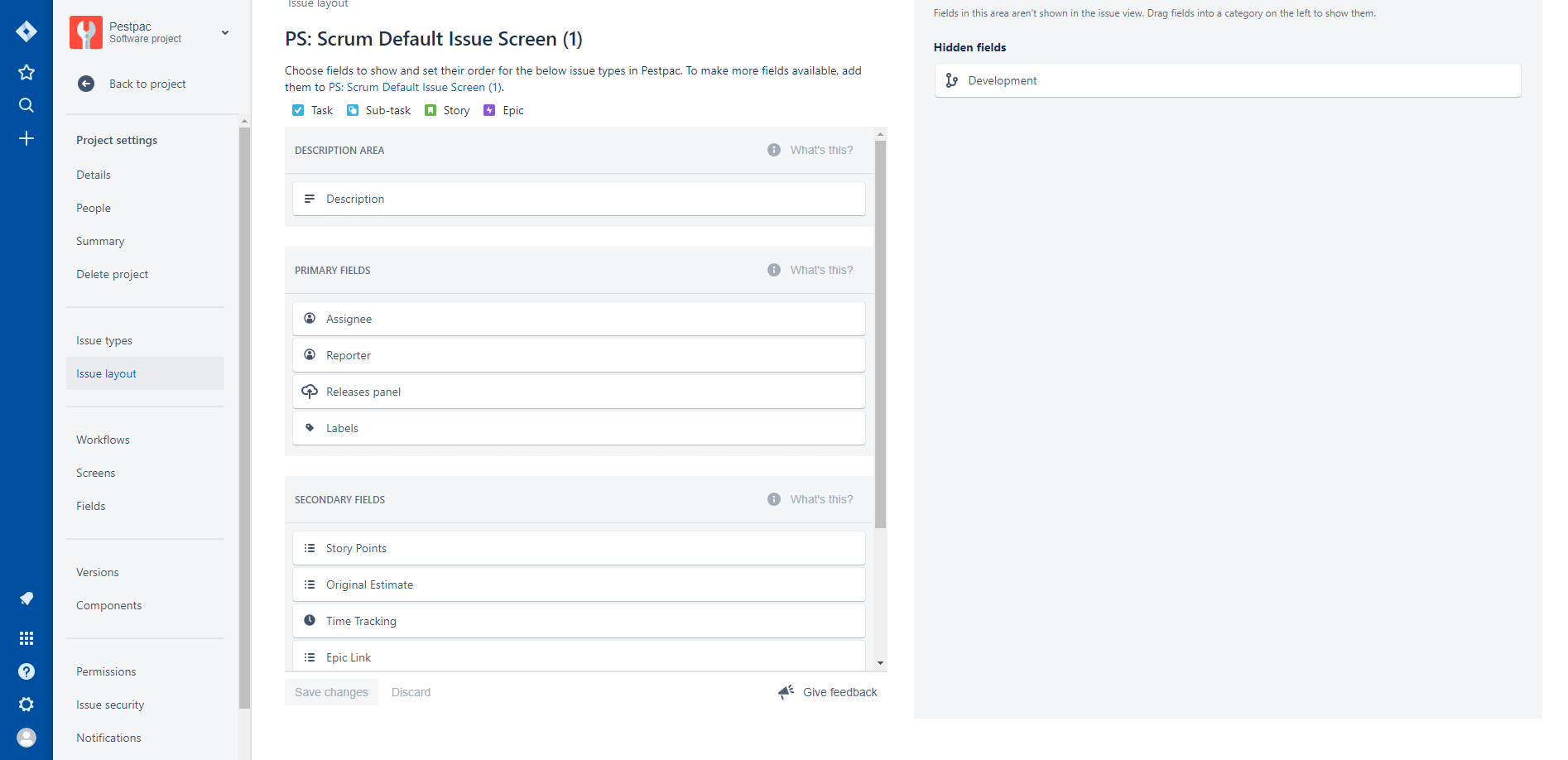

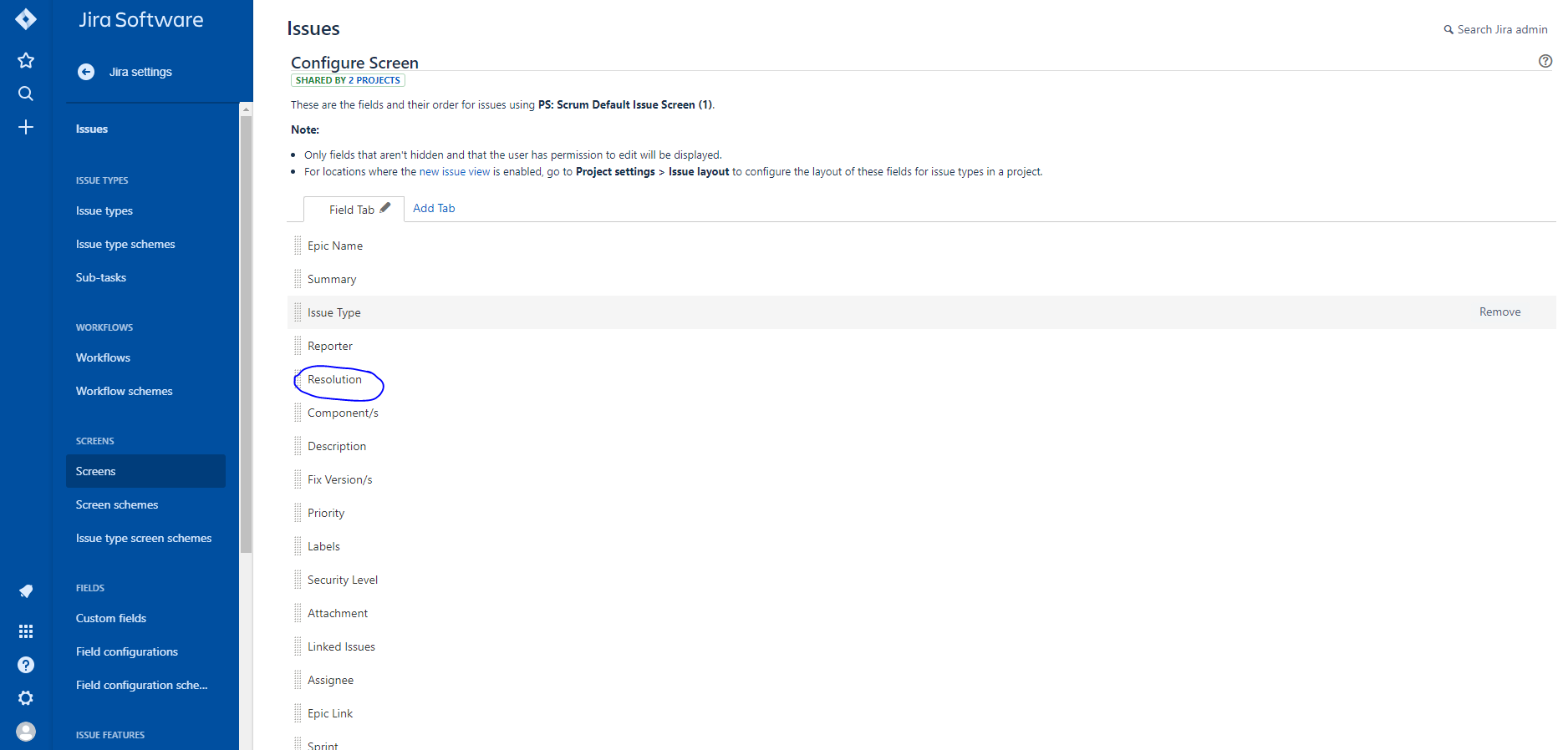

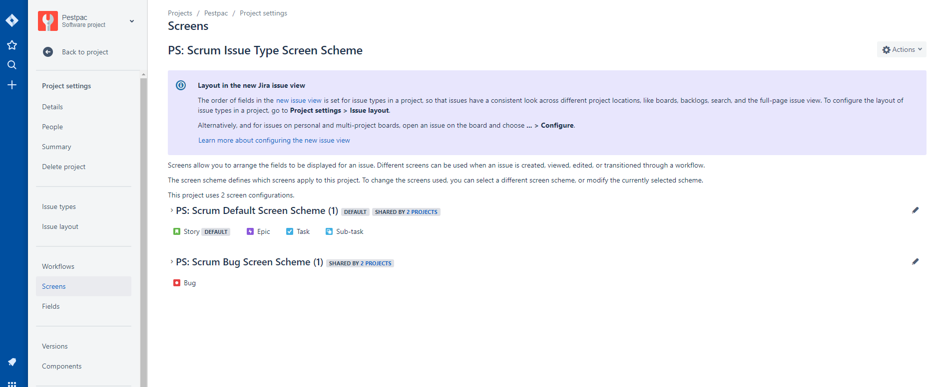

I was able to add a transition that captures the resolution type.
However, after saving it the resolution type is not displayed on the issue screen nor is the issue being striked through like it's done. The comments I enter on the resolution transfer screen are appearing on the issue screen.
So how do I get the resolution field to show on issue screens and how do I get the completed issues to strike through?
Here's some screenshots that might help.
Hello Michael,
I hope you are having a nice day.
The new issue view of JIRA does not display the resolution field by default. This is a behavior implemented to avoid confusion regarding the Resolution field, as it happened in the old issue view.
That been said, there are the two possible ways that you can configure the resolution field to be set when the issue is done and get the issue to strike through in the board.
- Navigate to your project > Project settings > Workflows > Click to edit your project workflow(s)
- On diagram mode, click in the transition that leads to the "Done" status (The last status of your workflow)
Choose one of the options below:
1 - In the right menu, click on Edit > Configure the resolve issue screen in the transition view, so the user will be asked to set a resolution when transitioning the issue to "Done"
2 - In the right menu, Click post functions > configure the post function Update issue field to set a value for the resolution field
For more information about the resolution field, check this documentation:
How to edit the resolution of an Issue
Let us know if this information helps.
Perfect! I think I was also including the wrong type of Post Function.
It's striked out now.
