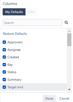

I want to create 2 different filters for 2 Jira projects. However, the setting has already been "Default" and I can no longer enable the "Filter" tab. Is there a way I can enable this so I can create 2 different filters? Please see attached image.

Hi @Norman , thanks for your question.
I have understood you are asking to restore the default view of the filter search results.
To do this from your own image, you just need to click on the option to 'Restore Defaults'
If I have misunderstood or you have follow up questions, please just reply here and either I or someone else will try to help you.
Cheers
Hi,
Thanks for responding. I tried to do your suggestion. However, the restored columns are no longer relevant and I've been trying to create 2 different columns for my 2 different projects. Do you have any idea how to do this?

Excuse me if I resume this question after a while, but I have the same starting point (the "Filter" buttn disabled) but I sipmply need to create a filter with some selected columns, in order to recall the same columns when I use the filter.
When I create a new filter the button is disabled and it only appears when I edit the filter already created.
How can I have it already enabled at filter creation ?
