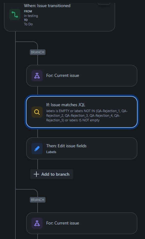

Whenever a task is transitioned from a status "In testing" to "To Do", I'd like to add a label that depends on which time such a change occurred, for example:
1st time transition from "In testing" to "To Do" --> add "label-1"
2nd time transition from "In testing" to "To Do" --> add "label-2" and remove "label-1"
3rd time transition from "In testing" to "To Do" --> add "label-3" and remove "label-2"
I tried 2 different approaches:
1st approach using advanced branching --> this behaves like a for loop and loops over until final label is reached

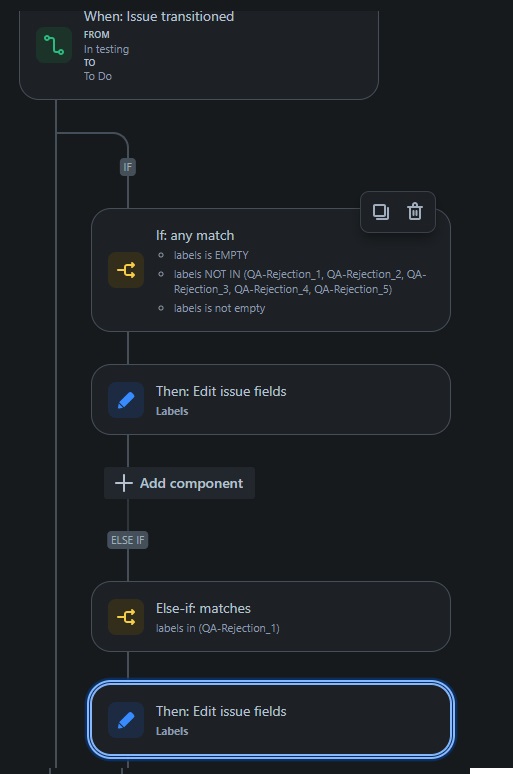

2nd approach using if/else if --> this works fine for the first iteration, so it adds the "label-1" but then every time it succeds (success in audit log) but there's no any change
Looking for any ideas how to fix that!
In your first condition in the if/else loop, you have both "labels is empty" and "labels is not empty", so it will always meet this criteria. I think you need to adjust that condition.
Hello Matt,
Thanks for your answer - there are OR operators everywhere
Hi @Michał Nowak ,
I think that's exactly what @Matt Parks is getting at. Your condition is "labels is empty OR labels is NOT empty", which will always be true.
If you can rely on the labels being applied correctly, I would build my conditions just with that, like so:
labels not in (label_1, label_2, label_3, label_4, label_5) => add label_1
else if labels = label_1 => remove label_1, add label_2
else if labels = label_2 => remove label_2, add label_3
..and so on.
