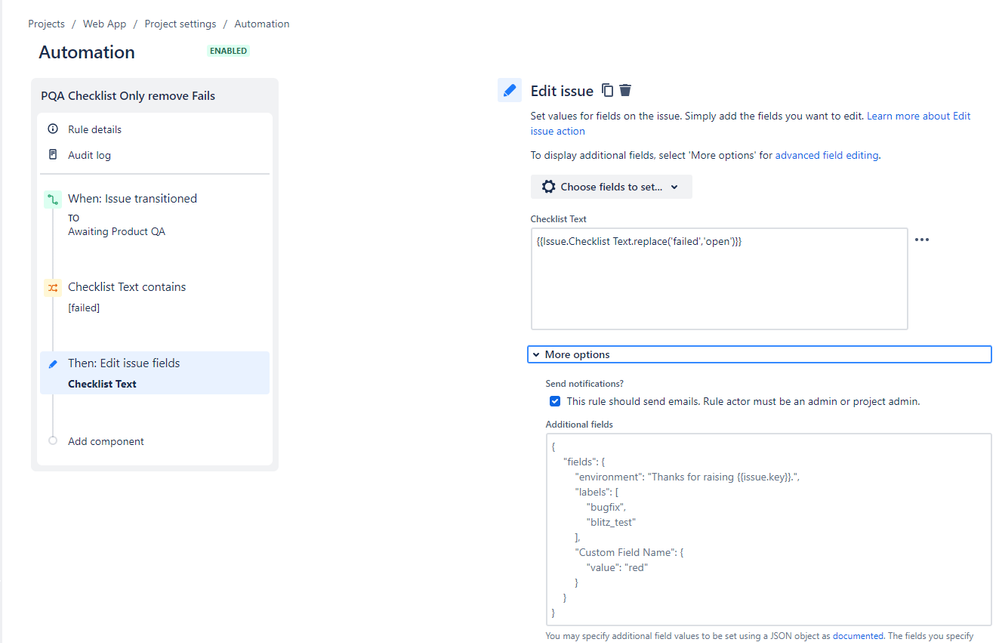

Thanks for this Bill.
This is an image of the automation
I've just tried with the replace() function but no success.
Actually i got it to work! I had ' instead of " grouping my target and replacements!
Thanks for your help, turns out it was Replace that works, Replace All does not!
