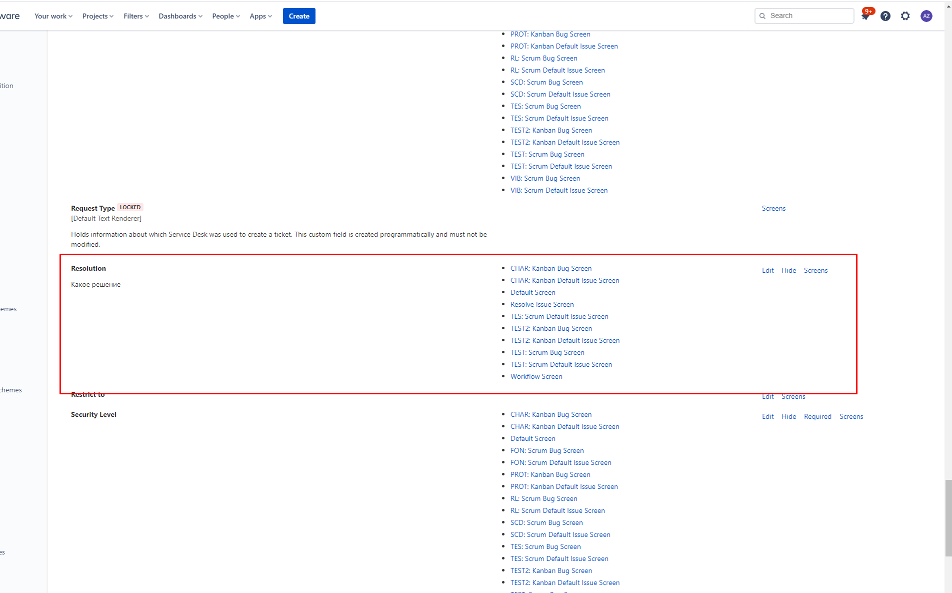

@Jack Brickey Thanks! But there is no button to make this field optional. I have Default Field Configuration - open it - find Resolution field - No "Required" or "Optional" button. What am i doing wrong?
